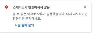

Actual result The space is not created, and the following error message appears:
"The space could not be created. Something went wrong for an unknown reason. Click Create to try again. Contact support."
Clicking Create again does not resolve the issue — the same error keeps appearing.

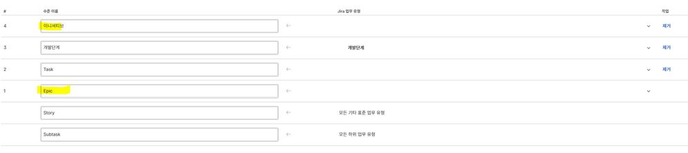

I checked our Work type hierarchy as suggested, but the configuration does not match the documented cause. In our setup, there is a valid level above Epic, and every level already has work types mapped:
Level 4 – Initiative: mapped to multiple initiative work types (Initiative, Issue Initiative, Design Initiative, Verification Initiative, Software Platform Initiative, Deployment Initiative, etc.)
Level 3 – 개발단계 (Development Stage): mapped to a work type
Level 2 – Task
Level 1 – Epic
Base – Story / Subtask
So Initiative is correctly sitting above Epic (level 4, not at the Epic level), and there are valid levels above Epic. Despite this, creating a space with the "Top-level planning" template still fails with the same generic "Something went wrong for an unknown reason" error. All other templates create successfully.

I've attached screenshots of the current Work type hierarchy configuration. Please let me know if you need our site URL, account ID, the exact timestamp of the failure, or browser console logs — I'm happy to provide them.

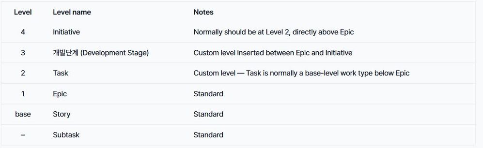

I did, however, notice something unusual about the ordering of our hierarchy that I'd like you to confirm. In a standard Jira setup, Initiative sits directly above Epic (Level 2). In our configuration, two custom levels have been inserted between Epic and Initiative, so Initiative has been pushed up to Level 4:
My main question is this:
Could the fact that Task and 개발단계 are inserted between Epic and Initiative — so that Initiative is no longer directly above Epic — be the reason the "Top-level planning" template fails?
Specifically:
1. Does this template expect the level directly above Epic (Level 2) to be the top-level planning level? If so, having Task (a base-level work type) placed in that position instead of Initiative could be causing the failure.
2. If this is the likely cause, what is the recommended way to fix it without disrupting our existing projects — for example, should I move Task back down to the base level and place Initiative directly above Epic?
Before making any changes to a live site, I'd like to confirm the cause with you first. I've attached screenshots of the current Work type hierarchy configuration. Please let me know if you need our site URL, account ID, the exact timestamp of the failure, or browser console logs — I'm happy to provide them.

Good you checked the hierarchy that closely. You're right that your setup doesn't match the cause in that KB, so scratch the bit about Initiative sitting at the Epic level.
The thing that changes the picture is what the template reaches for when it provisions. It only goes one level up from Epic, so it uses whatever work type sits directly above Epic (level 2) to create the top item. Initiative being pushed up to level 4 doesn't factor in on its own. The catch is that the slot directly above Epic is now one of your inserted types (Task or 개발단계), and the template can't provision a base type like Task in that spot, so it falls over with the same generic "something went wrong" message.
So the thing to try is to put a proper above-Epic type at level 2, directly over Epic, even if you keep the extra levels higher up, then run the create again. Also confirm you're doing this in a company-managed project, since anything at level 2 and above only works there.
