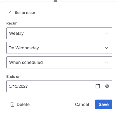

Varsha Joshi
May 13, 2026
Hi @Hernandez-Ramos_ Joey
This following setting seems to be working for me. Did you pick some other options?
Williams_ Kieanya
May 14, 2026
The error Joey and team are experiencing is when we hit Save after this point. It says to "Something went wrong on our end... contact support"
