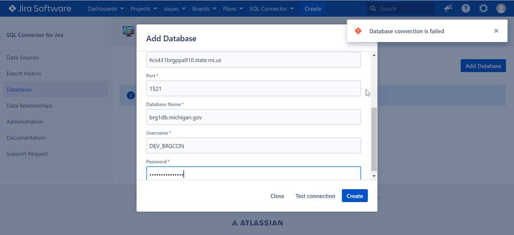

Hi i am using jira data center , i installed app sql connecter for jira , trying to connect to database by providing proper details , while testing connection , getting error like failed to connect.
can some tell me why?

Yes , because i successfully connected from script runner from same jira center,
now i want to connect using sql connector for jira

  • Can your server resolve the name of your database host? jira is running on my pc localhost instance
  • i can reach to my db server because i already connected to my db from script runner from same jira instance
