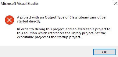

Thanks. I had this piece of code but it fails for all Output Type
A. for Out put type Windows and console both gives : Error "Program does not contain a statuS  'Main' method suitable for an entry point. Looks like the Main definition is not being accepted and it is running on .NET Framework 4.7
B. Class Library : gives :Error

I did say it was untested.
The basic steps to run a query via the cloud API are in there, you will need to write your own script or troubleshoot my pseudocode
