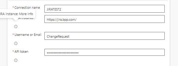

Hi there we are facing issue connecting Jira to power automate and when we try to connect it's throwing an error Unable to connect to JIRA due to JSON error.
Require guidance on this as we are facing this issue for a while.

Test connection failed. Details: Please check your credentials and try again. <html> <head> <title>Unauthorized (401)</title> <!--[if IE]><![endif]--> <script type="text/javascript"> (function() { var contextPath = ''; function printDeprecatedMsg() { if (console && console.warn) { console.warn('DEPRECATED JS - contextPath global variable has been deprecated since 7.4.0. Use `wrm/context-path` module instead.'); } } Object.defineProperty(window, 'contextPath', { get: function() { printDeprecatedMsg(); return contextPath; }, set: function(value) { printDeprecatedMsg(); contextPath = value; } }); })(); </script> <script> window.WRM=window.WRM||{};window.WRM._unparsedData=window.WRM._unparsedData||{};window.WRM._unparsedErrors=window.WRM._unparsedErrors||{}; WRM._unparsedData["com.atlassian.plugins.atlassian-plugins-webresource-plugin:context-path.context-path"]="\"\""; WRM._unparsedData["jira.core:feature-flags-data.feature-flag-data"]="{\"enabled-feature-keys\":[\"com.atlassian.jira.agile.darkfeature.editable.detailsview\",\"nps.survey.inline.dialog\",\"com.atlassian.jira.agile.darkfeature.edit.closed.sprint.enabled\",\"jira.plugin.devstatus.phasetwo\",\"jira.frother.reporter.field\",\"atlassian.rest.xsrf.legacy.enabled\",\"jira.issue.status.lozenge\",\"com.atlassian.jira.config.BIG_PIPE\",\"com.atlassian.jira.projects.issuenavigator\",\"com.atlassian.jira.config.PDL\",\"jira.plugin.devstatus.phasetwo.enabled\",\"atlassian.aui.raphael.disabled\",\"applinks.v3.ui\",\"app-switcher.new\",\"frother.assignee.field\",\"com.atlassian.jira.projects.ProjectCentricNavigation.Switch\",\"jira.onboarding.cyoa\",\"com.atlassian.jira.agile.darkfeature.kanplan.enabled\",\"com.atlassian.jira.config.ProjectConfig.MENU\",\"com.atlassian.jira.projects.sidebar.DEFER_RESOURCES\",\"com.atlassian.jira.agile.darkfeature.kanplan.epics.and.versions.enabled\",\"com.atlassian.jira.agile.darkfeature.sprint.goal.enabled\",\"jira.zdu.admin-updates-ui\",\"jira.zdu.jmx-monitoring\",\"mail.batching.enabled\",\"sd.new.settings.sidebar.location.disabled\",\"jira.zdu.cluster-upgrade-state\",\"com.atlassian.jira.email.templates.readFromJiraHome\",\"com.atlassian.jira.agile.darkfeature.splitissue\",\"com.atlassian.jira.config.CoreFeatures.LICENSE_ROLES_ENABLED\",\"jira.export.csv.enabled\"],\"feature-flag-states\":{\"data.pipeline.feature.jira.issue.history.export\":true,\"com.atlassian.jira.security.endpoint.non.admin.access.screens\":false,\"com.atlassian.jira.mailHandlerImapMessageQueryLegacy\":false,\"com.atlassian.jira.security.endpoint.non.browse.projects.access.fields\":false,\"com.atlassian.jira.webhookEventsAsyncProcessing\":true,\"atlassian.cdn.static.assets\":true,\"jira.richeditor.bidi.warning\":true,\"mail.batching\":false,\"com.atlassian.jira.diagnostics.perflog\":true,\"com.atlassian.jira.privateEntitiesEditable\":true,\"com.atlassian.jira.security.endpoint.anonymous.access.priority\":false,\"com.atlassian.jira.dbr\":true,\"com.atlassian.jira.issuetable.move.links.hidden\":true,\"jira.priorities.per.project.edit.default\":false,\"com.atlassian.jira.agile.darkfeature.unlink.sprints.on.issue.move\":true,\"jira.renderer.consider.variable.format\":true,\"com.atlassian.jira.user.dbIdBasedKeyGenerationStrategy\":true,\"com.atlassian.jira.plugin.issuenavigator.jql.autocomplete.eagerlyLoaded\":false,\"com.atlassian.jira.agile.darkfeature.issues.in.epic.details.view\":true,\"com.atlassian.portfolio.dcBundling\":true,\"jira.priorities.per.project.jsd\":true,\"com.atlassian.jira.plugin.issuenavigator.anonymousPreventCfData\":false,\"com.atlassian.jira.agile.darkfeature.rapid.boards.bands\":true,\"com.atlassian.jira.sharedEntityEditRights\":true,\"com.atlassian.jira.agile.darkfeature.flexible.boards\":true,\"com.atlassian.jira.agile.darkfeature.sprint.picker.allsprints.suggestion\":true,\"com.atlassian.jira.security.endpoint.anonymous.access.resolution\":false,\"com.atlassian.jira.agile.darkfeature.sprint.goal\":false,\"jira.dc.lock.leasing\":true,\"com.atlassian.jira.accessibility.personal.settings\":true,\"jira.cluster.monitoring.show.offline.nodes\":true,\"mail.batching.create.section.cf\":true,\"com.atlassian.jira.commentReactions\":true,\"data.pipeline.feature.jira.issue.links.export\":true,\"com.atlassian.jira.security.endpoint.non.browse.projects.access.autocompletedata\":false,\"com.atlassian.jira.custom.csv.escaper\":true,\"com.atlassian.mail.server.managers.hostname.verification\":true,\"com.atlassian.jira.fixedCommentDeletionNotifications\":true,\"com.atlassian.jira.plugin.issuenavigator.filtersUxImprovment\":true,\"com.atlassian.jira.agile.darkfeature.kanplan.epics.and.versions\":false,\"com.atlassian.jira.jsd.mobile\":true,\"jira.customfields.cleanup.identification\":false,\"data.pipeline.feature.jira.all.exportable.custom.fields\":true,\"com.atlassian.jira.defaultValuesForSystemFields\":true,\"com.atlassian.advancedroadmaps.rebrand\":true,\"com.atlassian.jira.upgrade.startup.fix.index\":true,\"jira.dc.cleanup.cluser.tasks\":true,\"jira.customfields.bulk.delete\":false,\"com.atlassian.jira.issues.archiving.filters\":false,\"mail.batching.override.core\":true,\"jira.users.and.roles.page.in.react\":true,\"jira.security.csp.sandbox\":true,\"com.atlassian.jira.security.endpoint.anonymous.access.projectCategory\":false,\"jira.redirect.anonymous.404.errors\":true,\"com.atlassian.jira.agile.darkfeature.velocity.chart.ui\":true,\"com.atlassian.jira.issuetable.draggable\":true,\"com.atlassian.jira.returnDefaultAvatarsForBrokenAvatars\":true,\"com.atlassian.jira.attachments.generate.unique.suffix\":true,\"com.atlassian.jira.agile.darkfeature.sprint.auto.management\":false,\"com.atlassian.jira.agile.darkfeature.kanban.hide.old.done.issues\":true,\"jira.version.based.node.reindex.service\":true,\"jira.jql.suggestrecentfields\":false,\"com.atlassian.jira.agile.darkfeature.backlog.showmore\":true,\"com.atlassian.jira.gdpr.rtbf\":true,\"com.atlassian.jira.agile.darkfeature.sprint.plan\":false,\"com.atlassian.jira.security.xsrf.session.token\":true,\"com.atlassian.jira.security.endpoint.anonymous.access.issueLinkType\":false,\"com.atlassian.jira.agile.darkfeature.optimistic.transitions\":true,\"com.atlassian.jira.security.project.admin.revoke.with.application.access\":true,\"com.atlassian.jiranomenclature\":true,\"com.atlassian.jira.security.endpoint.non.admin.access.avatar.system\":false,\"com.atlassian.jira.security.LegacyJiraTypeResolver.WARN_ONLY\":false,\"com.atlassian.jira.agile.darkfeature.kanplan\":false,\"data.pipeline.feature.jira.schema.version.2\":true,\"com.atlassian.jira.agile.darkfeature.burnupchart\":true,\"com.atlassian.jira.agile.darkfeature.velocity.sprint.picker\":false,\"com.atlassian.jira.issues.archiving.browse\":true,\"com.atlassian.jira.agile.darkfeature.future.sprint.dates\":true,\"jira.instrumentation.laas\":false,\"com.atlassian.jira.filtersAndDashboardsShareableWithAllGroupsAndRoles\":true,\"jira.customfields.paginated.ui\":true,\"com.atlassian.jira.agile.darkfeature.edit.closed.sprint\":false,\"mail.batching.user.notification\":true,\"jira.create.linked.issue\":true,\"com.atlassian.jira.agile.darkfeature.dataonpageload\":true,\"com.atlassian.jira.advanced.audit.log\":true,\"jira.sal.host.connect.accessor.existing.transaction.will.create.transactions\":true,\"data.pipeline.feature.jira.archived.issue.export\":false,\"external.links.new.window\":true,\"jira.quick.search\":true,\"com.atlassian.jira.projects.per.project.permission.query\":true,\"jira.jql.smartautoselectfirst\":false,\"com.atlassian.jira.issues.archiving\":true,\"index.use.snappy\":true,\"jira.priorities.per.project\":true,\"jira.jql.membersof.ignoreGlobalPermissionsForAnonymous\":false}}"; WRM._unparsedData["jira.core:default-comment-security-level-data.DefaultCommentSecurityLevelHelpLink"]="{\"extraClasses\":\"default-comment-level-help\",\"title\":\"Commenting on an Issue\",\"url\":\"https://docs.atlassian.com/jira/jcore-docs-0820/Editing+and+collaborating+on+issues#Editingandcollaboratingonissues-restrictacomment\",\"isLocal\":false}"; WRM._unparsedData["com.atlassian.analytics.analytics-client:policy-update-init.policy-update-data-provider"]="false"; WRM._unparsedData["com.atlassian.analytics.analytics-client:programmatic-analytics-init.programmatic-analytics-data-provider"]="false"; WRM._unparsedData["jira.core:dateFormatProvider.allFormats"]="{\"dateFormats\":{\"meridiem\":[\"AM\",\"PM\"],\"eras\":[\"BC\",\"AD\"],\"months\":[\"January\",\"February\",\"March\",\"April\",\"May\",\"June\",\"July\",\"August\",\"September\",\"October\",\"November\",\"December\"],\"monthsShort\":[\"Jan\",\"Feb\",\"Mar\",\"Apr\",\"May\",\"Jun\",\"Jul\",\"Aug\",\"Sep\",\"Oct\",\"Nov\",\"Dec\"],\"weekdaysShort\":[\"Sun\",\"Mon\",\"Tue\",\"Wed\",\"Thu\",\"Fri\",\"Sat\"],\"weekdays\":[\"Sunday\",\"Monday\",\"Tuesday\",\"Wednesday\",\"Thursday\",\"Friday\",\"Saturday\"]},\"lookAndFeelFormats\":{\"relativize\":\"true\",\"time\":\"h:mm a\",\"day\":\"EEEE h:mm a\",\"dmy\":\"dd/MMM/yy\",\"complete\":\"dd/MMM/yy h:mm a\"}}"; WRM._unparsedData["jira.core:avatar-picker-data.data"]="{}"; WRM._unparsedData["jira.core:terminology-data.terminology"]="{\"terminologyEntries\":[{\"originalName\":\"sprint\",\"originalNamePlural\":\"sprints\",\"newName\":\"sprint\",\"newNamePlural\":\"sprints\",\"isDefault\":true},{\"originalName\":\"epic\",\"originalNamePlural\":\"epics\",\"newName\":\"epic\",\"newNamePlural\":\"epics\",\"isDefault\":true}],\"isTerminologyActive\":false}"; WRM._unparsedData["com.atlassian.jira.jira-header-plugin:dismissedFlags.flags"]="{\"dismissed\":[]}"; WRM._unparsedData["com.atlassian.jira.jira-header-plugin:newsletter-signup-tip-init.newsletterSignup"]="{\"signupDescription\":\"Get updates, inspiration and best practices from the team behind Jira.\",\"formUrl\":\"https://www.atlassian.com/apis/exact-target/{0}/subscribe?mailingListId=1401671\",\"signupTitle\":\"Sign up!\",\"signupId\":\"newsletter-signup-tip\",\"showNewsletterTip\":false}"; WRM._unparsedData["com.atlassian.jira.project-templates-plugin:project-templates-plugin-resources.ptAnalyticsData"]="{\"instanceCreatedDate\":\"2018-03-20\"}"; WRM._unparsedData["jira.core:user-message-flags-data.adminLockout"]="{}"; WRM._unparsedData["com.atlassian.plugins.helptips.jira-help-tips:help-tip-manager.JiraHelpTipData"]="{\"anonymous\":true}"; if(window.WRM._dataArrived)window.WRM._dataArrived();</script> <link type="text/css" rel="stylesheet" href="/s/dd94b2ea8cda4c3b24b696bcd0c3109f-CDN/-4n13xp/820001/7cl3m3/c95955c3a0b2b5bb35a047ca6970ceb9/_/download/contextbatch/css/_super/batch.css" data-wrm-key="_super" data-wrm-batch-type="context" media="all"> <link type="text/css" rel="stylesheet" href="/s/edc1c5ce1fa739990782ee768a314e06-CDN/-4n13xp/820001/7cl3m3/6b042e1acc3559a709765f968faf4f9a/_/download/contextbatch/css/atl.general,jira.global,-_super/batch.css?agile_global_admin_condition=true&amp;jag=true" data-wrm-key="atl.general,jira.global,-_super" data-wrm-batch-type="context" media="all"> <script type="text/javascript" src="/s/fb2cb1490afba5ae20de95db4d6ee805-CDN/-4n13xp/820001/7cl3m3/c95955c3a0b2b5bb35a047ca6970ceb9/_/download/contextbatch/js/_super/batch.js?locale=en-UK" data-wrm-key="_super" data-wrm-batch-type="context" data-initially-rendered></script> <script type="text/javascript" src="/s/d45737f3e3489fdfd771d469b617780e-CDN/-4n13xp/820001/7cl3m3/6b042e1acc3559a709765f968faf4f9a/_/download/contextbatch/js/atl.general,jira.global,-_super/batch.js?agile_global_admin_condition=true&amp;jag=true&amp;locale=en-UK" data-wrm-key="atl.general,jira.global,-_super" data-wrm-batch-type="context" data-initially-rendered></script> <script type="text/javascript" src="/s/6601d96f833a7049ad0c9a1d3409a29b-CDN/-4n13xp/820001/7cl3m3/18cb3007e50ee4bcdc2ea448718715de/_/download/contextbatch/js/atl.global,-_super/batch.js?locale=en-UK" data-wrm-key="atl.global,-_super" data-wrm-batch-type="context" data-initially-rendered></script> <link type="text/css" rel="stylesheet" href="/s/cdb0c32ca7be55e3b21b55476a5a90d5-CDN/-4n13xp/820001/7cl3m3/b18d3497ffc2a8d1aa68d9fd201b8ce4/_/download/contextbatch/css/jira.global.look-and-feel,-_super/batch.css" data-wrm-key="jira.global.look-and-feel,-_super" data-wrm-batch-type="context" media="all"> <script type="text/javascript" src="/rest/api/1.0/shortcuts/820001/1c486d6fd0000dd75f8fd92ec2c00006/shortcuts.js"></script> <script> window._AP = window._AP || {}; window._AP.dialogOptions = { }; window._AP.inlineDialogOptions = { }; </script> <meta name="application-name" content="JIRA" data-name="jira" data-version="8.20.1"> </head> <body id="jira" class="aui-layout aui-style-default page-type-message " data-version="8.20.1" > <!-- HTTPError401 --> <div class="aui-page-panel" ><div class="aui-page-panel-inner"> <main role="main" id="main" class="aui-page-panel-content" > <div class="aui-page-header" ><div class="aui-page-header-inner"> <div class="aui-page-header-main" > <h1>Unauthorized (401)</h1> </div> </div></div> <div class="aui-message aui-message-warning warning"> <p>Encountered a <code>&quot;401 - Unauthorized&quot;</code> error while loading this page.</p> <p>Basic Authentication Failure - Reason : AUTHENTICATED_FAILED</p> <p><a href="/secure/MyJiraHome.jspa">Go to Jira home</a></p> </div> </main> </div></div> </body> </html>

I have managed to get the connection working again, by using my normal login password instead of an API key. I am certain I tried this before, so If you are suffering the same issue and believe you have already tried using your password instead of an API key, try again.

Ok, that makes sense, you're hitting the base url of a Jira and getting the HTML of the login page.
My guess is that whatever you are trying to connect with is not expecting to connect to the Jira UI, it probably should be trying to connect to the REST API.
Where is the credentials box you've got in the screenshot coming from?  Is it a dialogue in an app in Jira?  Or is it another application?

Thats the credentials we are using - I have tried with both the personal and Atlassian Tokens
