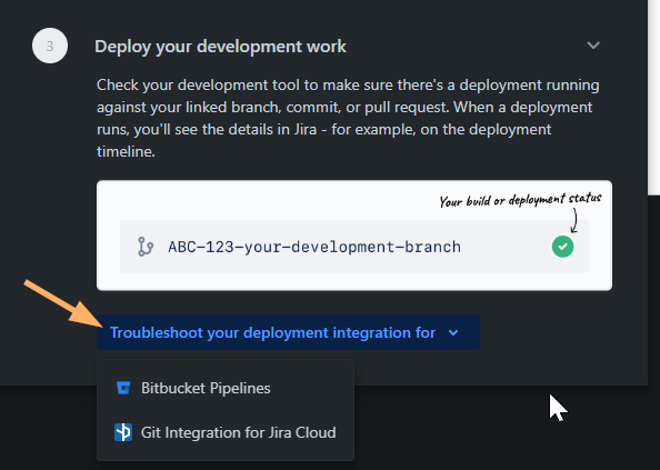

I have been trying to Enable and Configure Deployments Feature in JIRA. The deployment feature is indeed enabled but it is stuck in the following last step:

Hi @Curt Holley thanks for replying.
I have read this documentation but I still am unable to configure this feature properly and stuck on the last step as mentioned in the image above.
I am using Azure Pipelines for deployments and I have also configured my Azure Pipelines for JIRA app but still this feature is not getting enabled for me.

But, what do you see when you click on "Troubleshoot your integration for" ?

Osama Abdul Ghafoor
May 8, 2023
@Curt Holley As I mentioned that I am successful in configuring this feature now.
I can see the deployments.
I see the deployments only when I have my Azure Pipelines connected to Azure repo but when I have my Bitbucket repo connected to pipelines then the deployments does not have any effect in JIRA issues.
I guess this is a limitation with Azure Pipelines for JIRA App:
Moreover, My JIRA is connected to Bitbucket as well.
Like Curt Holley likes this
Curt Holley
May 8, 2023
Safe to say that not seeing bitbucket is a limitation of the Azure Pipelines for JIRA App
