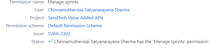

I'm a jira admin and i have the permission to Manage the sprint .

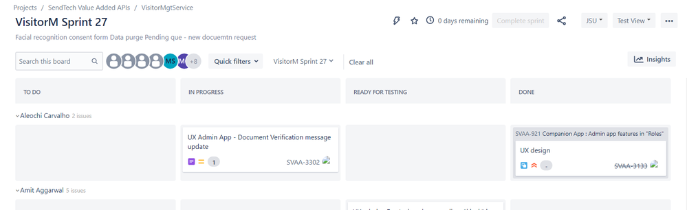

But i'm not able to close the sprint . that option was grayed out .
i checked out permission helper and its said i have that permission .
I looked the filter too , its related to only one project . please help
its not about global permissions also because i'm able to close sprint for other projects.

Check to see if there is a ticket from another project in your sprint. If there is, check your perms in that project.

try
Sprint = xxxx

Balaji Shriram Murkute
June 28, 2023
Hi @CHINNAMUTHEVISAI.SATYANARAYANASHARMA ,
Manage sprint permission is depends on the below permission.
Product access,
Browse project,
Edit issue,
Schedule issue.
Could you please check this mentioned permission and try.
Regards,
Balaji Murkute.
June 28, 2023
A board/sprint can be configured with issues from multiple projects. To complete a Sprint in a board, you must have the Schedule Issues and Manage Sprints permissions for all the projects returned in the board filter and in the Sprint, not just the project where the board is allocated.
