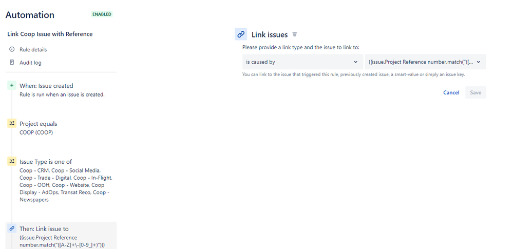

I am trying to link two issues together through an automation.
The desire is for the ticket to grab the data entered in a custom field and create a 'caused by' link in the ticket when a certain transition trigger happens.
This image shows the automation rule:

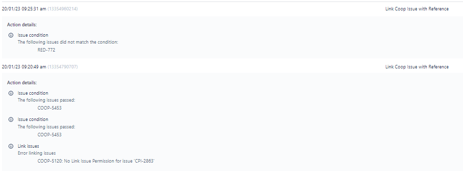

Below is the audit which indicates a permission issue:

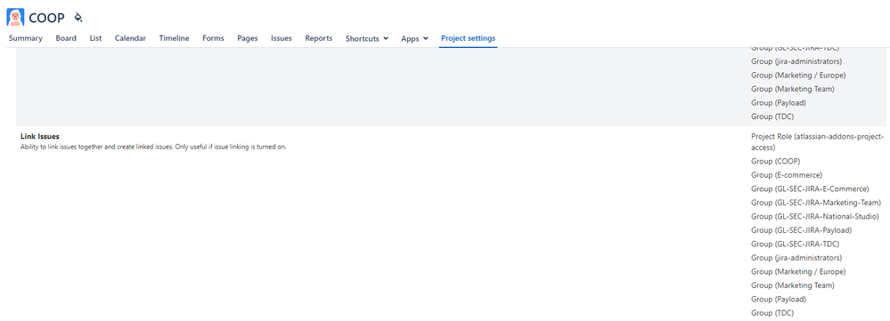

However I have link permission in both project and it is confirmed permission helper.

Hi @LouiseJ Rivet - I see that this is cross-project.  Can you please confirm that in the rule details the scope is either set to "Global" or Multiple Projects with all relevant projects captured?

Hi Mark,
Thank you for your answer we are indeed on a global automation.
Thank you!

Hi Mark, yes I am able to manually add linked issues on both projects.
Thank you.

Mark Segall
January 24, 2023
Maybe verify the rule actor has rights.  Since you've proven you are able to successfully create links with your account, make yourself the rule actor and see if it works.  If it does, it's just a matter of making sure the rule actor account has rights to the applicable projects.
