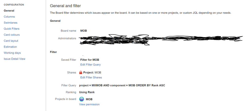

Hi Kamala,
Are you able to share a screenshot of the General Configuration for this board? I'm hoping that there might be something listed there which might help explain what is going on.
Thanks!
Here is a screen shot of the board in which i am not able to create an auto schedule
Here is a screenshot of board configuration where i am ABLE to auto schedule issue.
