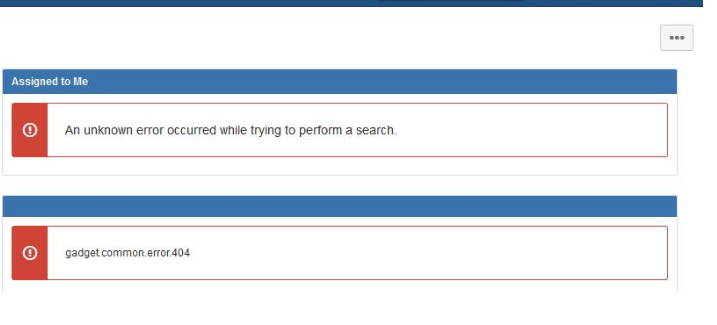

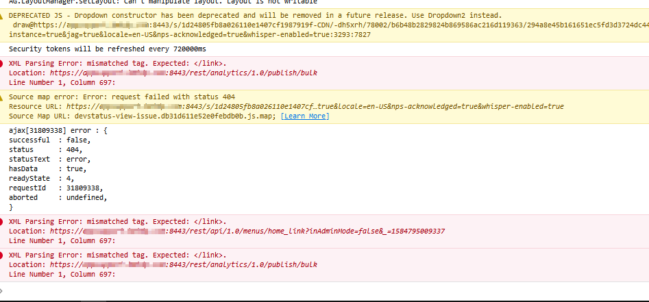

Here is the contents of my server.xml right now I am getting a lot of 404 errors
