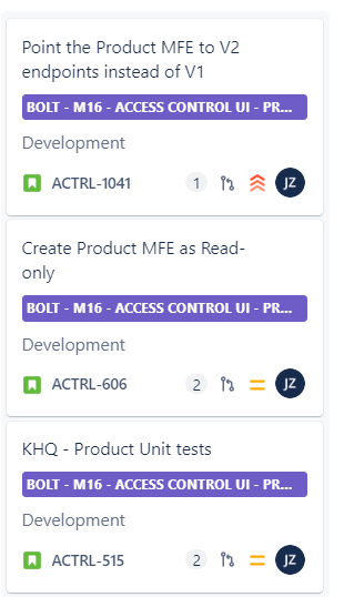

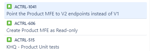

@Nic Brough -Adaptavist- I've checked and the ACTRL parent portion of the query pulls in a total of 3 tickets. I've confirmed that all three of these appear on the board as expected. Should I be checking anything else to confirm if that is the issue? Below I've attached image 1, which ACTRL tickets appear from the filter query, and image 2, which ACTRL tickets appear on the board (under the In Progress column)

I also might be missing something, but if I pull in the full project and can complete the sprint, wouldn't that imply that if I pull in a subset of the tickets (like from a certain Epic), I should also be able to complete the sprint? If those 3 tickets are causing the issue, they would also get pulled in with the rest of the ACTRL project, so wouldn't I expect the same behaviour of not being able to close the sprint?
Any suggestions on what to check would be great. Apologies if I am missing something or misunderstanding your comment.
January 10, 2024
Yes, parent = x is probably returning issues that are not on the board.
I would want to
  • compare the whole board filter with the parent=x filter to see what the differences are
  • Run a search for just "sprint = x", naming the sprint you are trying to close,
  • Given those two, look at why the issues it returns are not on the board
