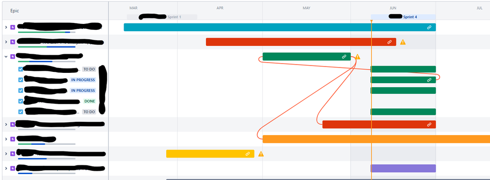

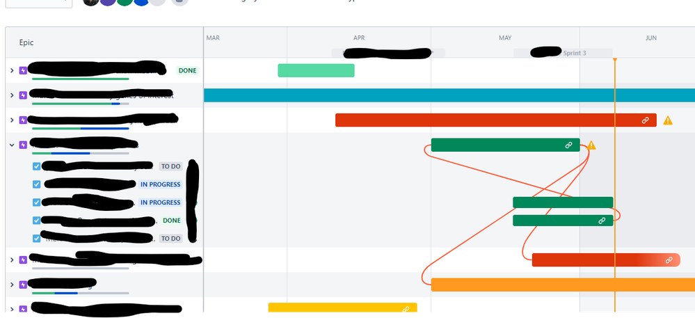

I have two filters that are basically the same (1st JQL is for the shorten key of the project, and the 2nd JQL is for the actual name of the project), caused by creating a scrum board in addition to the board already in the project.
This resulted in have the roadmap illustrating only half of the sprints (the other half is in the parallel board).
How can I delete/combine both filters/boards?

Both filter are the same JQL, the difference is how the project is defined
I mean -
filters:
A: project = MYP ORDER BY Rank ASC
B: project = MyProject ORDER BY Rank ASC
So both board A (based on filter A), and SCRUM board A (based on filter B) exists.
If I replace the filter in one to the other it won't change any of the issues (as it should), but it won't merge the sprints.
When I try to review the roadmap of the project I need to change the board to see sprints that are created in the other board, all while both boards are actually the same (scope-wise)
How can I merge filter A and filter B/delete one of the boards without loosing the sprint information?

You mean that you can't see issues with a specific sprint which belong to filter b when viewing the roadmap based on filter a? Can you share a screenshot or two?
Shachar Tzuk-Bazak
June 8, 2022
I meant: the second board shouldn't exists, as well as the second filter (filter A and filter B are equivalent). How can I merge/delete without loosing the sprint information and affiliation of the issues?
