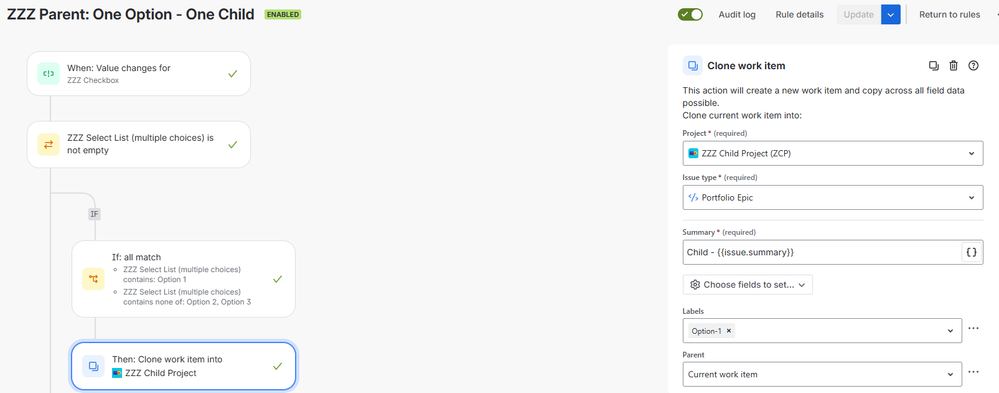

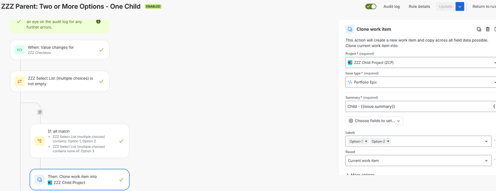

I have configured two jira rules in Jira Cloud as below.
Problem: When selecting only one option (Option 1) in Select List (multiple choices) on Parent, two Child issues are created instead of one.
I want that:
- If user selects Option 1 in Select Field, Only one child should be created via Jira Rule 1
- If user selects Option 1 and Option 2 in Select Field, Only one child should be created via Jira Rule 2. (It should ignore Rule 1 in this case)
Jira Rule 1:
Jira Rule 2:
Please provide necessary steps/ conditions/ screenshots to setup the required Rule config, to achieve the requirement.
