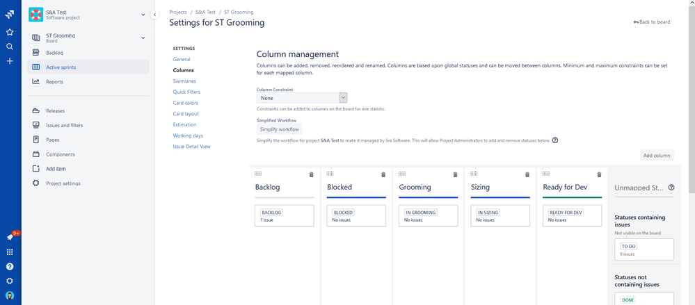

I want to have 2 boards, one Kanban and one Scrum.
I want Kanban board to have the following statuses:
- Backlog
- Blocked
- Selected
- Grooming
- Sizing
- Ready for Dev

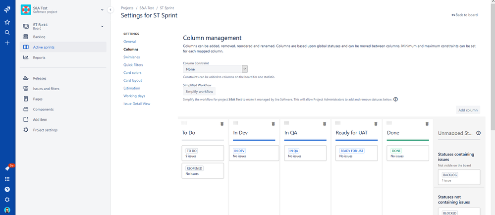

I want the Scrum board to have the following:
To Do / Reopened
In Dev
In QA
In UAT
Done

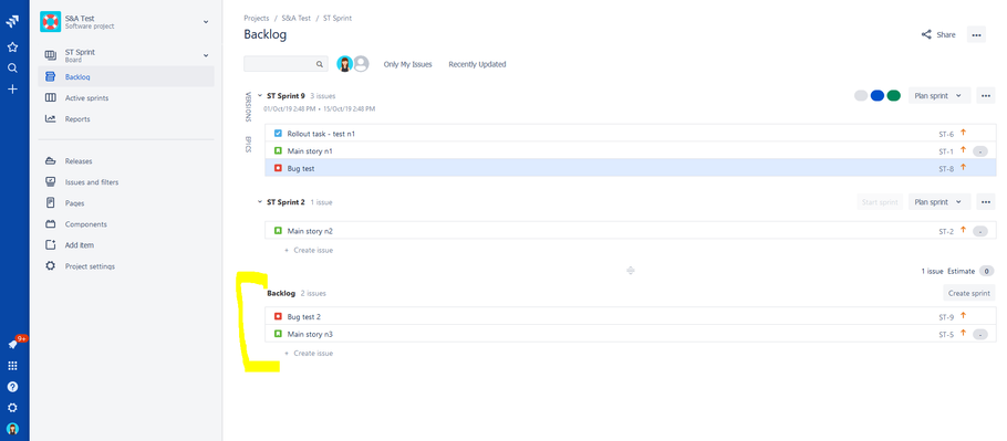

I want them to have the same backlog, and everything that shows up on the Kanban board to be in the backlog list, everything in current sprint - on the sprint board
How can I achieve this?
EDIT: By the way, if anyone is wondering about the same thing:
https://community.atlassian.com/t5/Jira-Software-questions/How-do-set-up-Grooming-and-Sprint-flow/qaq-p/1191817#M54787

Anna Pahlevanyan
May 20, 2020
I actually got it to work! See the link I left above
