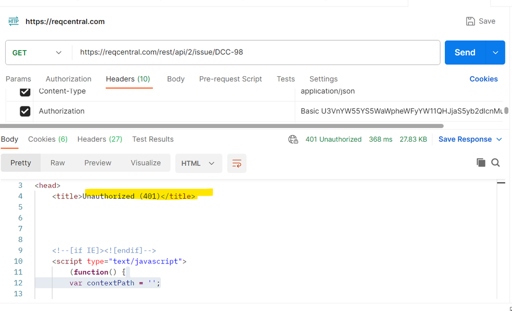

Suganya Vijayaramu
November 29, 2023
Hi i tried with the example in the doc, by converting emailaddress:api_token into a base64 string and then pass that string inside an authorization header. Please find the screenshot.  still getting Unauthorized error.

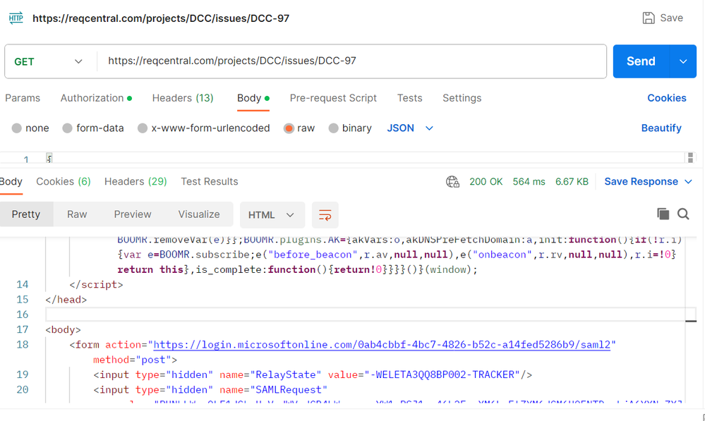

Suganya Vijayaramu
November 29, 2023
Hi Manoj, Happy Day. I tried to access one of JIRA issue in postman, by passing my user emai & API token (which created through Atalassian account) in request payload. It redirected to microsoft login page. PFB screenshot.  And could you please help to confirm , am i using correct API token or i should create token  in JIRA - API token Authenctication section to authenticate JIRA
