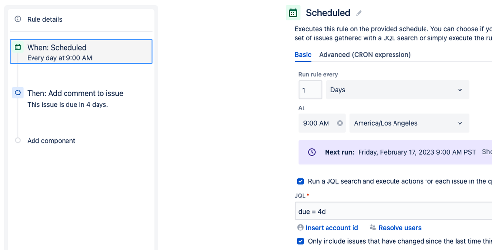

I was trying to follow the article below but I don't believe we use 'due dates.' Was wondering if there's a way to set up an automation so that it sends a reminder like 4 days before the sprint ends? Are there other articles I can follow for this?
I have two options that you could use, the first one would be to have two automations. The first one would trigger on when the sprint starts and it would set the due dates on all issues associated with that sprint. The second automation would then be based on the article you found.
The second one would use REST API calls to get the end date for the sprint and then compare that to now to see if the email should be sent. This option is more complicated since you need to know the sprint Id in order to get the end date.

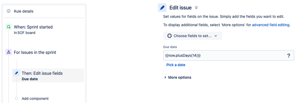

The automation would look something like this:
Got it - so set that up and then how do I do the email trigger when ~3/4 days out from the sprint end date?

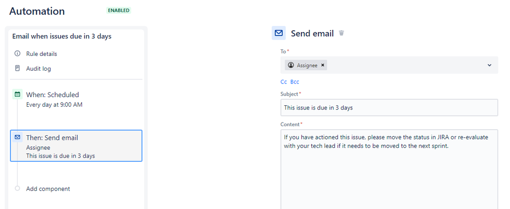

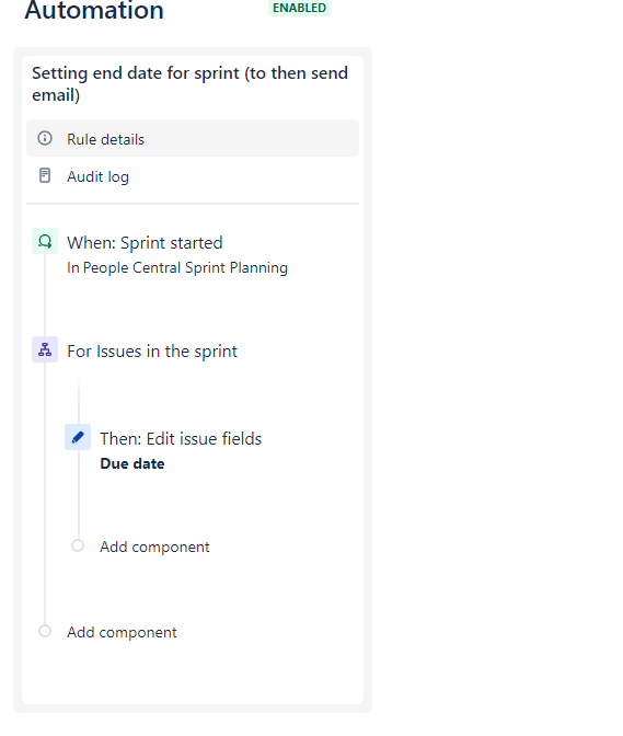

Thank you so much - here's the two rules I've created. I assume they have to be separate correct? Also, if I'm trying to send an email versus a comment to the issue, is this the right "assignee" to pick to send it to who is assigned to the story?

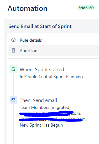

Maybe you can help me with this one too - I'm trying to send an email at the beginning of a sprint to let people know its open. It works for the CCs when I put in myself and someone else, but I can't figure out who's the right person to send "to" for it to send to all those assigned to issues. I've tried both "assignee/(s)" and "team members" but it seems to error out and only send to the CCs. Ideas?
The sprint doesn't have an assignee, or team members so you need to know who to send the email to. You could do a lookupIssues and use that to send out the email. But that would generate an email for each issue, so I would probably use a group email instead.

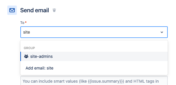

Just create a group in Jira and then add the users that should receive the email to that group. Then in the automation you can use that group in the to field like this:
Got it - quickly changing back to the prior topic above, for the emailing assignees 4 days before issues are complete, can you confirm if I need to put special criteria to ensure this does NOT send for issues that are done/complete?
In the JQL that is being used by the automation, just add statusCategory != Done to it and that will exclude any issues that are in a Done status (green color if you look at the workflow).

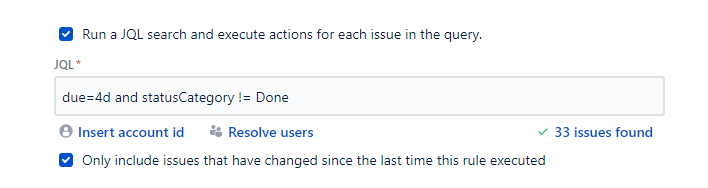

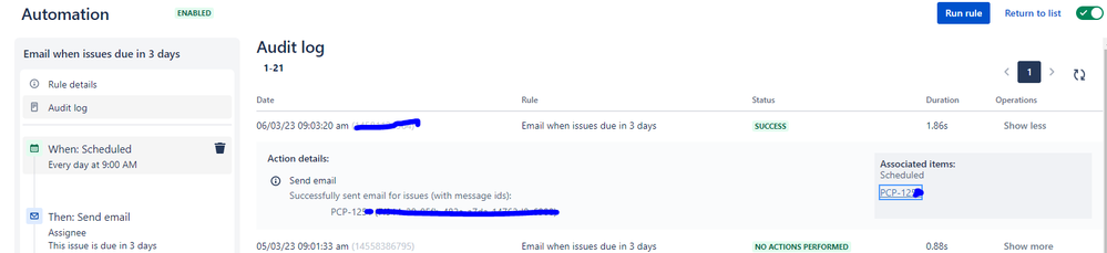

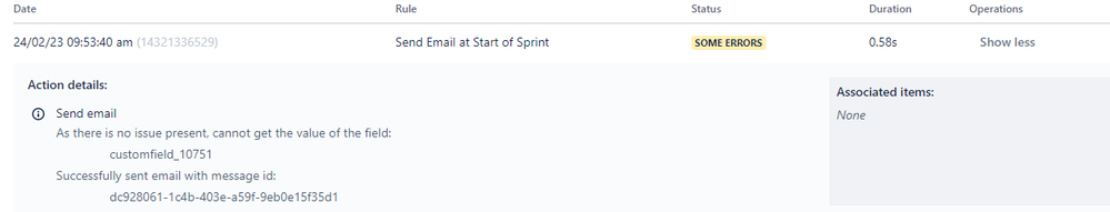

Hi Mikael - today was the day this email notification was set to run (4 days before due date of 3/10); looks like it only went for one story? Any idea how to troubleshoot?
The easiest way to troubleshoot is to run the JQL and see how many issues it returns.
Like this? Does this mean it was sent to 33 but the audit log just doesn't have them all or what?
If you uncheck the "Only include issues..." that should help. Because you are checking the due date it should should only include issues one time in the automation.
Here is what I would do, make a copy of your rule and instead of sending an email just create a log action that you set to maybe {{issue.key}} and then run the rule. You would then see if all 33 issues are included in the rule or not. If they are after unchecking the "Only include issues..." I would manually run the original one if you want to send out the emails.
So the admin pointed me to create a "team", but when I do that I don't see the option to send email to the team within automation. Is it possible? Or do I need to really get him to create a group?
You need to get him to create a group, teams are not yet available in Automation. Team is just in it's early stages, more features around should be coming in Q3-Q4 2023 based on Atlassian's public roadmap.
