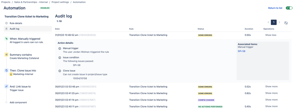

I have created an automation that is manually triggered in which a subtask is cloned, added to a different proejct as a task, and then linked to the trigger issue (subtask). When I run this rule I get a message that the issue could not be cloned and moved. Any idea how to get this to work?

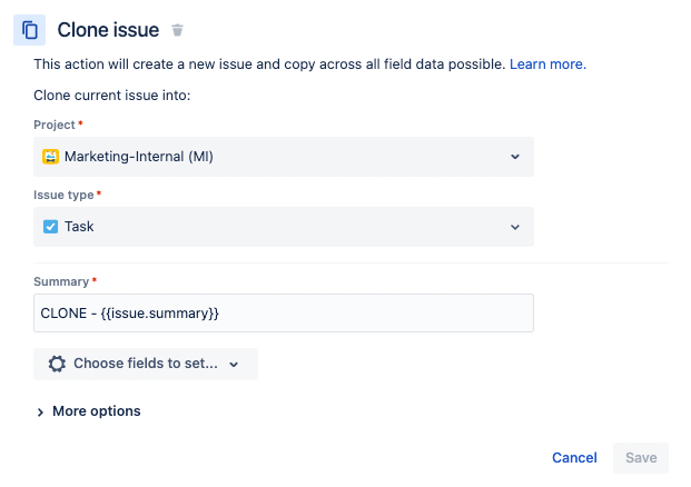

Please see the clone issue action screenshot below. I've instructed this subtask to be cloned, as a task, to the Marketing Project board (which does all for tasks as issue types). Can you clarify what you mean by the Create Issue dialog?

The error message you got indicates that an issue of a particular type can't be created in a particular project, and provides the IDs of each.
project ID = 10054
issue type ID = 10158
Can you navigate to the destination project to confirm these are the correct IDs?

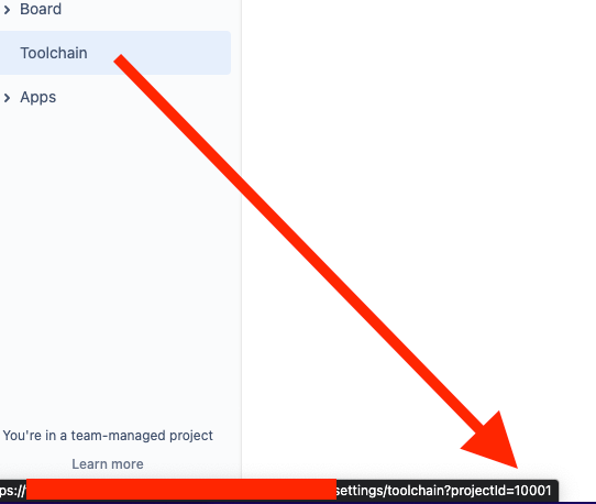

You said this was a team managed project, so go to that project and select Project Settings.
If you then hover over the Toolchain option, the project ID will display in the URL shown at the bottom of the browser.

Check if those IDs match the IDs in the error message.

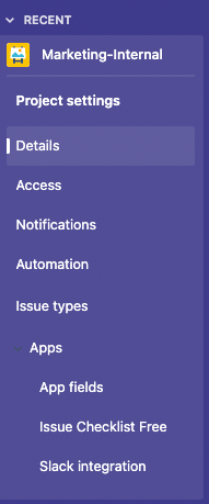

Thanks for sticking this out and helping me try to resolve. It is a team managed software project and I do not see Toolchain when I click project settings (see image) - is there somewhere else I can look?

In the Clone action could you possible have selected the Issue Type and then changed your selection for the Project? Can you try deleting that step and re-adding it? Makie sure that you select the destination project and then select the Issue Type.

The project ID is a match: 10054 but the Issue ID is not: should be 10115  vs. what the error message is saying (10158).

I will try to to delete the Clone step and redo - selecting the project first.
Jordan Wolman
February 2, 2023
That worked! Thank you so much!
