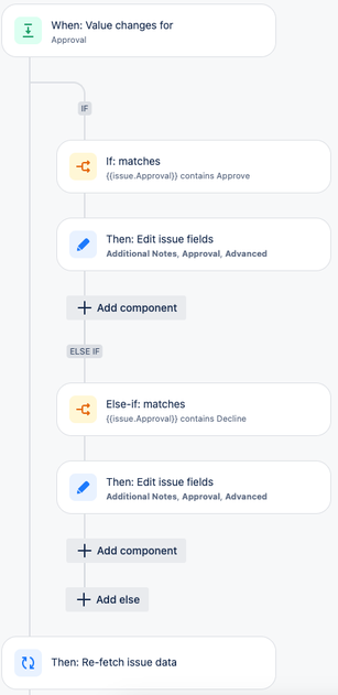

Basically you need a new custom field that is used for the approval/decline log, and I'm using a second one that I use in the automation to see which transition was selected. As part of the transition I have a post function that sets the field Approval to either approve or decline based on the transition. And the automation looks like this:
After the re-fetch there is there is the check to see if the approvers field is empty and if so then transition the issue to in review.
