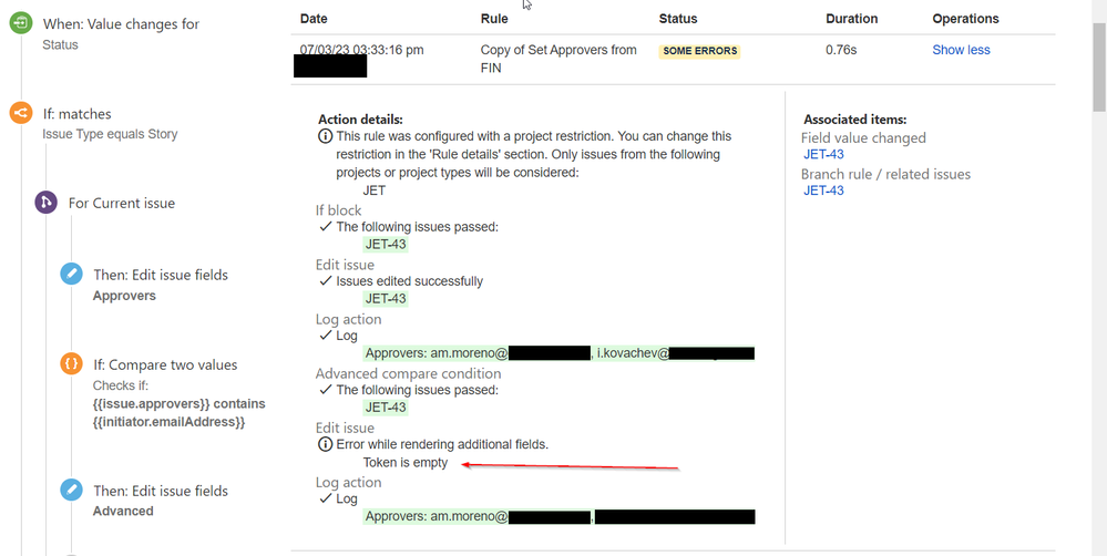

Hello Community,
I'm trying to configure automation to set a field called "Approvers" (multi-user picker) but then add a condition that IF one of the approvers is the initiator  --> remove their name/email as one of the approvers from the field.
One of my customers would like this as a safeguard so that if one of the approvers IS the ticket creator, they cannot self-approve their own request.

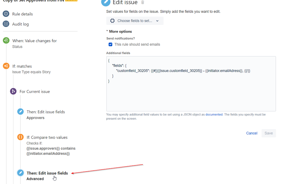

Screenshots of automation configuration below:
Note: in screenshots I changed the "create issue" trigger to "field value change" for ease of testing.
Everything seems to be ok until I get to the 2nd "Edit issue field (Advanced)".  I've tried several variations but get errors every time.
Any help truly appreciated.
Thank you very much and Kind Regards,
Amed
Mikael Sandberg
March 7, 2023

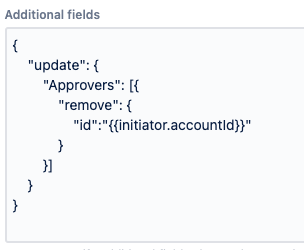

When you are adding/removing a user from a user picker field you have to use the Atlassian Id, and that is why you get the Token is empty error. The advanced edit should look something like this:

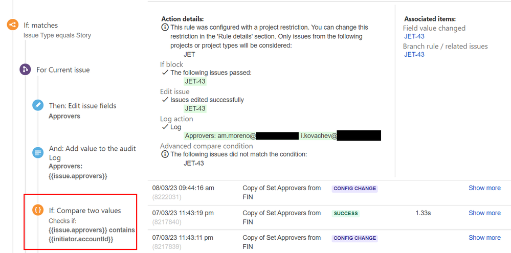

Hi Mikael,

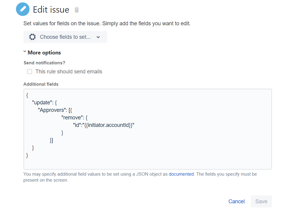

Thanks so much for the help and response but it did not work.  This time, no error, success but did not actually remove the initiator.  When I use accountId in condition, it does not pass the condition, I used emailAddress in condition so it passes and then your config in advanced but not expected result.
Mikael Sandberg
March 8, 2023
Is the approvers field a user picker field or a text field? Based on your log it makes me thing that you are using a text field, because if you are using a user picker field {{issue.approvers}} should give you the Atlassian Id instead of the email address.

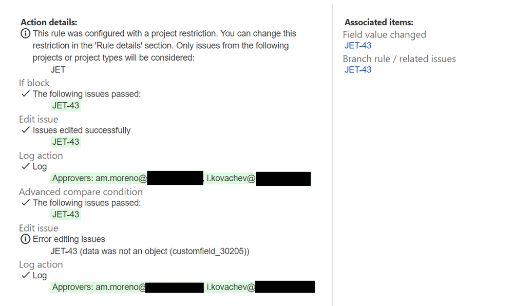

@Mikael Sandberg
Thanks again.  Yes, Data Center :).  This time got error below:
Amed Moreno
March 8, 2023
This is a multi-user picker field
Mikael Sandberg
March 8, 2023

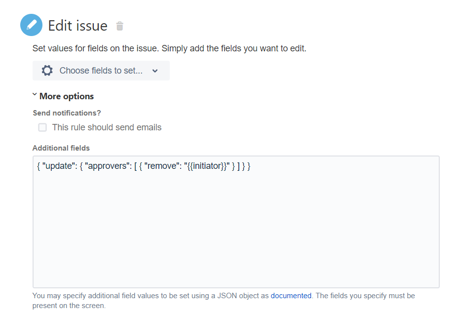

Okay, try this:
{"update": {"approvers": [{"remove": {"name":"{{initiator}}"}}]}}
Amed Moreno
March 9, 2023
@Mikael Sandberg
It worked!!! :)

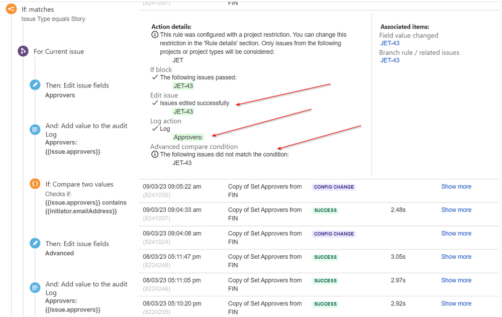

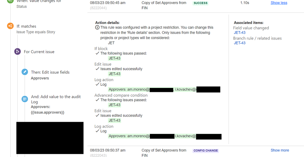

However, I do have a strange behavior I was wondering you can help me figure out.  This has happened to me with automations before.  Not sure if it's a Server/Data Center quirk.

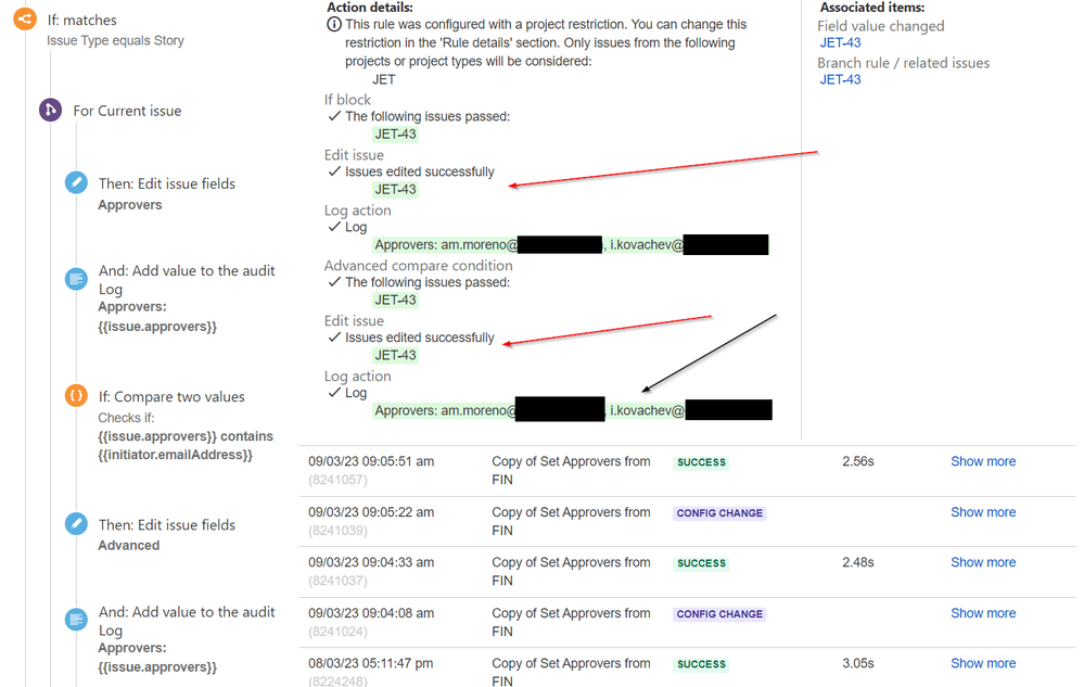

I have to run the automation twice.  The first run will fill the value of both approvers ( I can see this in the ticket) but the proceeding log in automation does not pick up the value and the condition to check "if initiator is in the approvers field" will return false (seen in screenshot 1).
When I run it again (with value of field populated with both users already), it runs successfully and removes the initiator but the last log at bottom of automation does not indicate the removal, still shows both users (seen in screenshot 2).
It's as if the automation is running too quickly to detect its own changes.  Have you every seen this behavior or is there an adjustment I can make to the automation rule to prevent this?
Thanks
Screenshots below:
Mikael Sandberg
March 9, 2023
This is expected, the automation only have access to the data in the issue at the time it was triggered. You can add the Re-fetch issue data after the edit of approvers and that should solve the issue.
