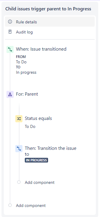

I've tried to set up an automation that transitions the parent issue from To Do -> In Progress when a child issue is manually transitioned from To Do -> In Progress.
Here's a snip of how I've set it up. What have I got wrong?

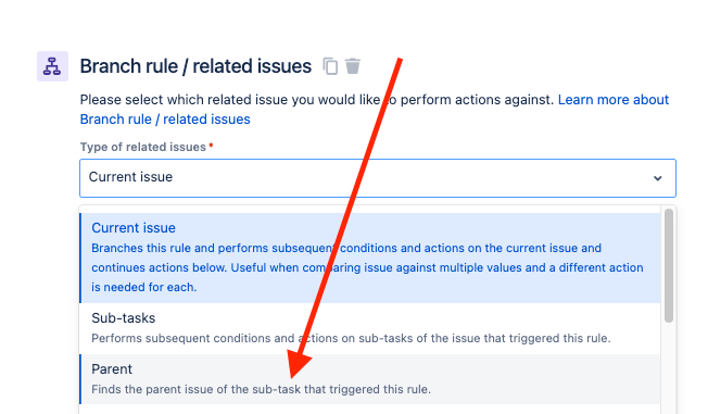

Hello @jonathan.wiebe
Please show us the details from the Audit Log where the execution result is No Actions Performed.
What is the issue type of the "parent" and the "child"?
The "Parent" related issue option works only when the trigger issue is a sub-task type of issue.

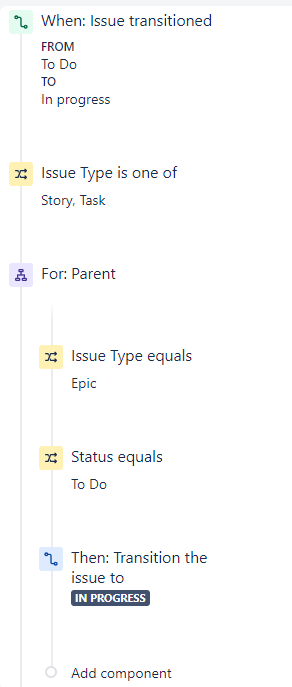

jonathan.wiebe
October 15, 2023
Added issue types, but haven't had a chance to test this new configuration.
Trudy P Claspill
October 15, 2023
That isn't going to work. As I said the Related Issues/ Parent is only appropriate when the trigger issue is a sub-task. The For branch will not find any matching parent issue for any other issue type
If you want the For branch to operate against parent issues that are Epics then you need to select the Related Issues / "Epic (parent)" option instead.

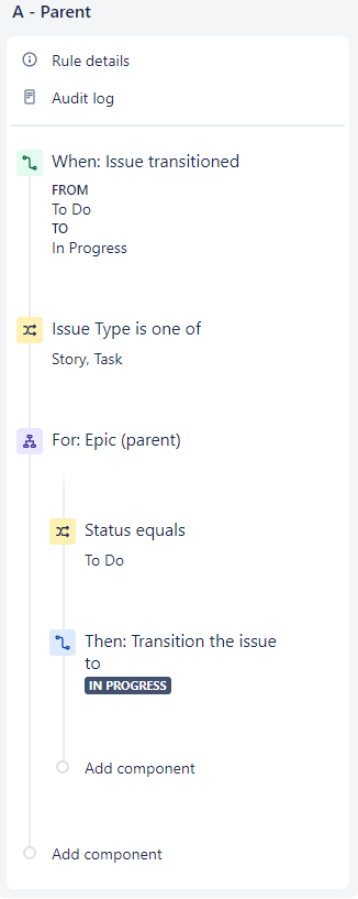

Tim Kopperud
October 16, 2023
Hi @jonathan.wiebe, here is an example of a rule if it is Epic as parent you are looking for, and not parent of sub-tasks.
Notice, as @Trudy P Claspill states in the comment, the brancing is Epic (parent) for this scenario.
You don't need the filter Issue Type equals Epic after the branching, because only Epics will enter this branch, hence it's already "filtered".
TimK.

jonathan.wiebe
October 16, 2023
This makes sense, now that I've discovered the "Epic (parent)" branching option. Hope to test soon. Thanks for the tip and screenshot!
jonathan.wiebe
October 27, 2023
I can confirm that this automation now works as intended! Thanks @Trudy P Claspill and @Tim Kopperud! Much appreciated!
