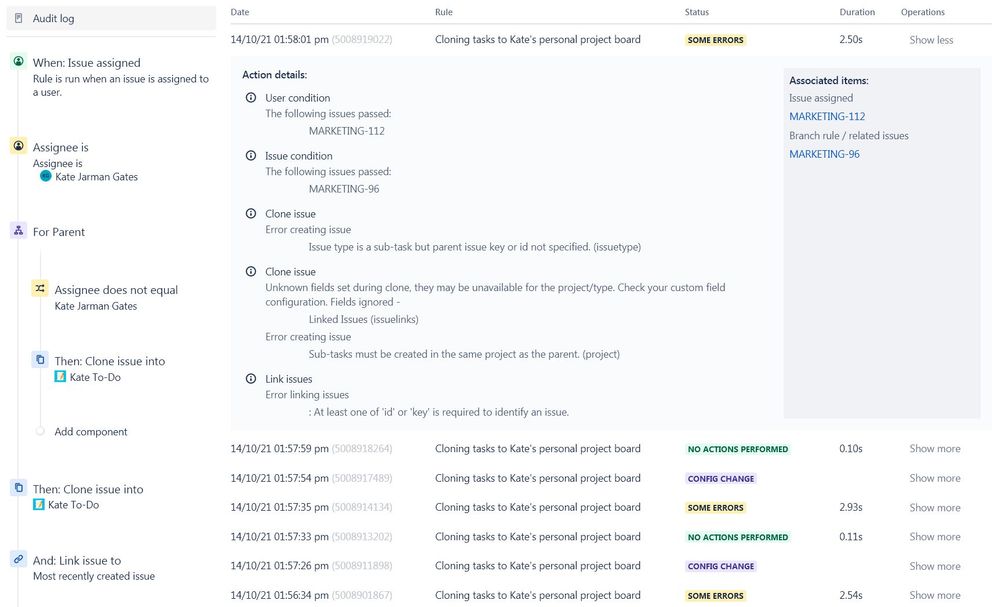

I'm specifically trying to do the following:
When a subtask is assigned to me (parent task is assigned to someone else) > Parent task and subtasks are cloned to another project > Clones are linked.
I've set up this automation, but it won't complete due to the indicated issues. I don't know how to resolve those issues. Any ideas?

Next, you do not show the details of your clone actions, and that error seems to indicate that you are changing the issue type.  Is that correct?  If so, the clone inside of the parent branch should use the same type as the parent; to do this, please select the option "same issue type" and not "same issue type as trigger".
And...please note your condition test on other assignees is inside of a branch...that means the second clone will attempt to happen even when you don't want it to happen.  You can prevent that by moving the condition earlier, before the branch, and using the If (with JQL) or Related Issues to Parent with JQL to check the assignee.
Finally...your rule is a great start, and may need more logic based upon different parent/child handling in Jira.  When the trigger issue is a task, story, or bug, the parent is an epic.  So your rule could work with that second clone...But, when the trigger issue is a sub-task, you will need to add a sub-task instead.  I do not know if that is easily doable to clone a subtask *and* change the parent in a rule.

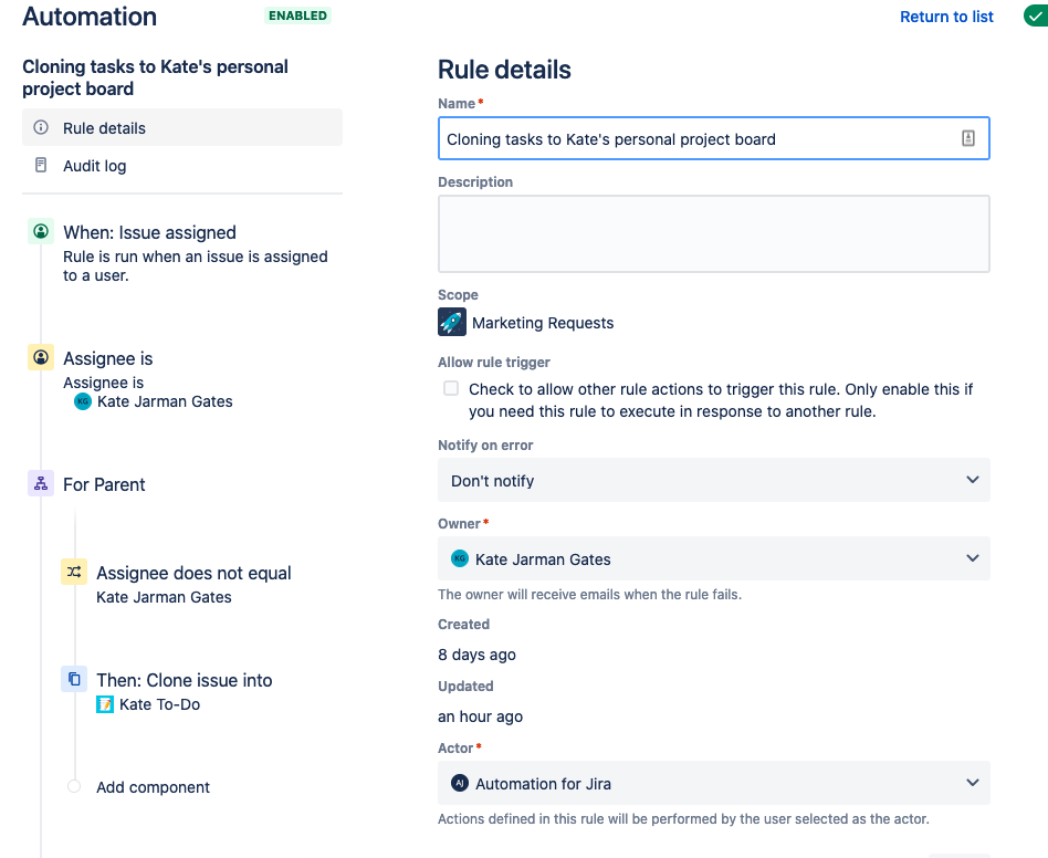

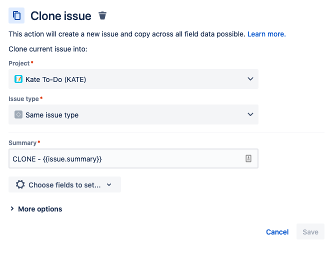

I'm not sure how but I've been able to get it to automatically clone parent issues assigned to me to a separate project without problem, it's just trying automating cloning assigned subtasks when someone else is assigned the parent task that I can't get it to do.
Here are some pictures, hope they help.Screen Shot 2021-10-14 at 5.04.50 PM.pngScreen Shot 2021-10-14 at 5.05.09 PM.png

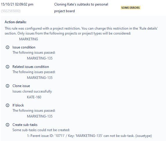

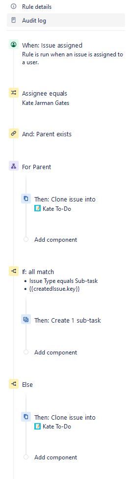

Hey that's getting somewhere! It cloned the parent task, which may be enough for me to work with. It didn't clone the subtask, though.cloning issue 1.JPGcloning issue 2.JPG
Bill Sheboy
October 15, 2021
Progress!

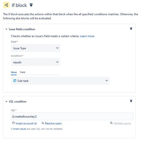

And please note in your first condition in the if/else that seems to have an extra check.  Would you please post an image of that?
Next, after that first condition in the if/else is where you need another branch in order to create the sub-task.  Start looking here in what I provided above:
  • branch: on JQL with key = {{createdIssue.key}
Bonè Å
October 15, 2021
I don't understand what it means to branch on JQL with key, so I did my best.
Bill Sheboy
October 15, 2021

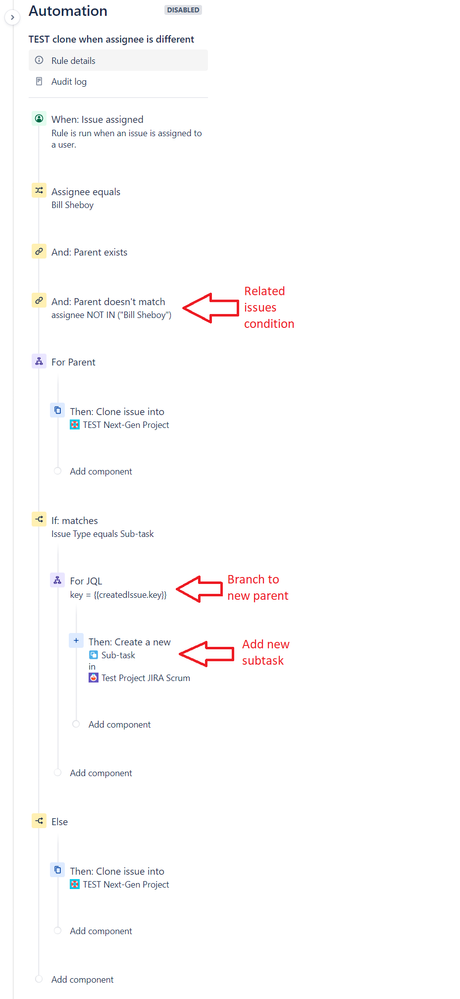

You are very close to finishing it.  For the condition you show, please delete the JQL condition so it only has the issue type test.
I'll post a full example of the rule, with some extra details to help.  This is similar to your rule, except with my name and projects.

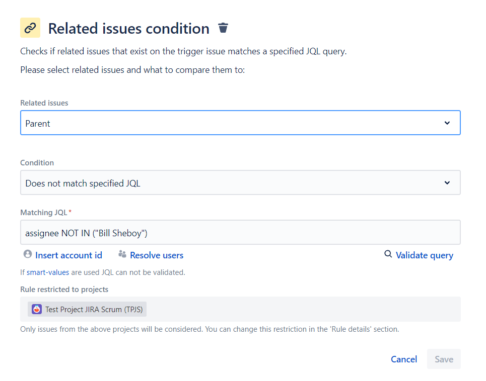

For the related issues condition, we are checking if the parent has a different assignee, as shown below.Capture 02.png

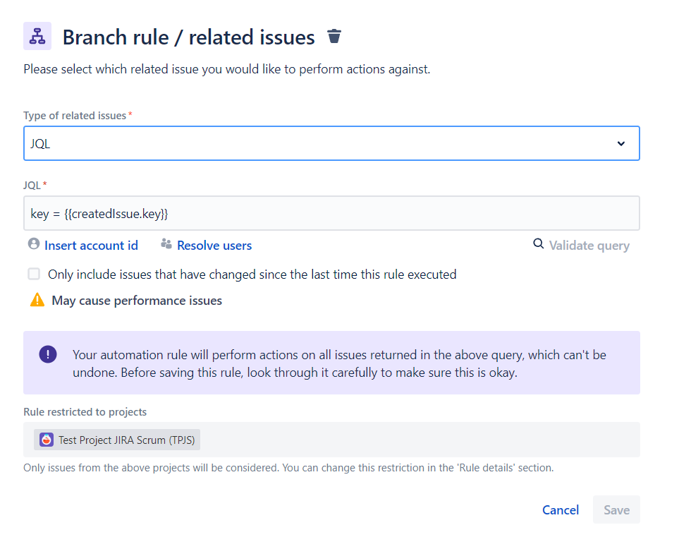

Later we branch to the new parent, selecting the Branch on JQL option.  This branch allows adding a subtask to the new parent.

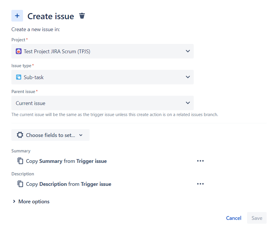

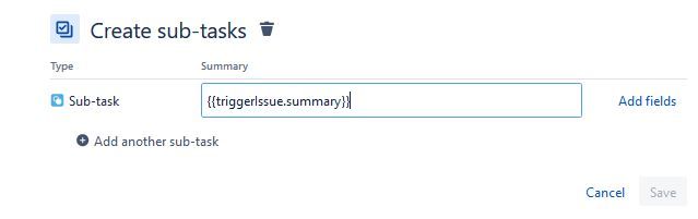

When creating the subtask, copy the fields from the trigger issue.
Then finally we handle the other case, where the child is not a sub-task.  Use clone  issue, copying the fields you need from the trigger issue.  When setting the Epic Link field, set it to {{createdIssue.key}}
