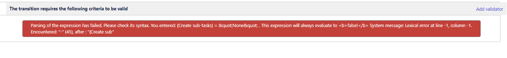

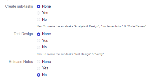

I am trying to check for the custom field "Create sub-tasks" which is a radio button and has the following value - None, Yes, No. I want to add a validator to check if the value is either Yes or No. However, when I have placed the validator, it shows me some errors.
Here is my custom field - Create sub-tasks.
Here are the errors I get.

So anyways, when you create a custom field of type Radio Button, if it is not set to be Required, then the "None" option shows up automatically.
But as @Alex Koxaras -Relational- correctly points out, it holds a value of 'null'.

It says - Parsing of the expression has failed. Please check its syntax. You entered: {Create sub-tasks} != null. This expression will always evaluate to <b>false!</b> System message: Lexical error at line -1, column -1. Encountered: "-" (45), after : "{Create sub"

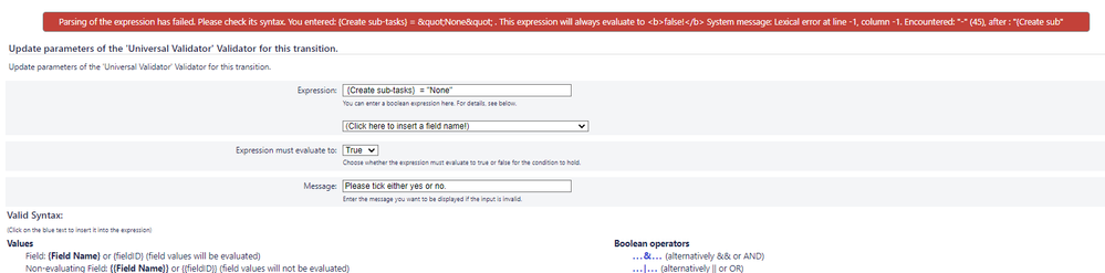

I am using -
Update parameters of the 'Universal Validator' Validator for this transition.

Still it doesn't work -
Parsing of the expression has failed. Please check its syntax. You entered: {Create Sub-tasks} != &quot; &quot;. This expression will always evaluate to <b>false!</b> System message: Lexical error at line -1, column -1. Encountered: "-" (45), after : "{Create Sub"
