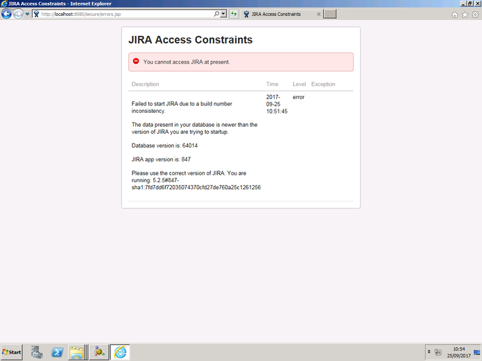

Thanks for the response. Please see the below for what I'm seeing in terms of an error message.
It's a clean install of 5.2.5 x32. I'm only seeing the following in the logs:
2017-09-25 10:52:48,824 localhost-startStop-1 ERROR      [atlassian.jira.service.OfBizServiceConfigStore] The class 'com.atlassian.jira.service.services.auditing.AuditLogCleaningService' could not be found.  This can happen when a plugin is uninstalled or disabled
2017-09-25 10:52:48,825 localhost-startStop-1 ERROR      [atlassian.jira.service.OfBizServiceConfigStore] A NoOp Service has been returned and hence 'Audit log cleaning service' will not do anything until fixed.
I have a feeling that the server is MSSQL 2008, but will check with our database team and report back.

Hi Ed,
I would check the target database again.  The error you're getting is stating the database is using version 64014 which is JIRA 6.4.
Make sure the version you're installing is indeed the 5.x version you had previously and retry on a supported database for that version of JIRA.

Ed Hams
September 25, 2017
Ahh thanks for that Branden - I was testing out a rollback so we'll need to do a manual restore.
