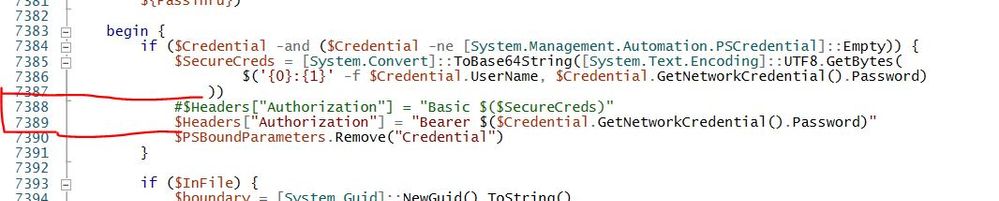

The issue is the way the header is being formed in the module. If you change the Authentication piece of the header in the Invoke-WebRequest function of the JiraPS.psm1 module file you can get it to work with a token. I would suggest a modification request be put in to update the JiraPS module to allow another parameter or a flag to permit the call to choose between bearer and basic authentication header. Here is the change I made to the module in order to get it to work with a PAT. Comment out the existing and paste in the second line shown below.
(line 7388 in the Invoke-WebRequest function)
#$Headers["Authorization"] = "Basic $($SecureCreds)"
$Headers["Authorization"] = "Bearer $($Credential.GetNetworkCredential().Password)"
Just a note: if you change this in your psm1 file, it will most likely break basic HTTP auth with userid/pwd. You may just want to include a local version of this function at the top of your powershell script that uses a PAT, and leave the base psm1 file alone. That way you just essentially override the function in the module with your local version. Just make sure if you script calls import-module JiraPS you do that BEFORE you put a local version of the invoke-webrequest function or you will still be using the module version.
