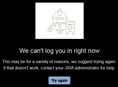

I am trying to configure SAML to work with our ADFS server, but I keep hitting the same wall:
From what I can tell: Jira is successfully redirecting the user login to the ADFS server, the user can successfully authenticate and the response is passed back to Jira, but Jira Datacenter's built-in SAML consumer does not like the response it is getting from ADFS. My instinct was to check logs on both the ADFS server and Jira. The ADFS logs show no errors, it looks like everything is working correctly. I don't think Jira is doing any logging for SAML, nor could I figure out how to enable SAML logging.

I spawned a support request for this issue and Jira support had a very helpful response. Unfortunately, I wasn't able to follow through with my troubleshooting; we decided not to implement our solution with ADFS and SAML.
Here is the suggestion Jira support provided:
Indeed the log files aren't providing a clear information regarding the error you're experiencing. Due to this and to see if we can get an additional information in the logs, would you mind to navigate through Jira Administration > System > Logging and Profiling and enable "debug" logging level for the class "com.atlassian.plugins.authentication"? To do so, you can click at "Configure logging level for another package".
After proceeding with the step above, ensure to replicate the problem once again and attach here a fresh Support Zip where we can double check if we can get an useful information in the logs.
