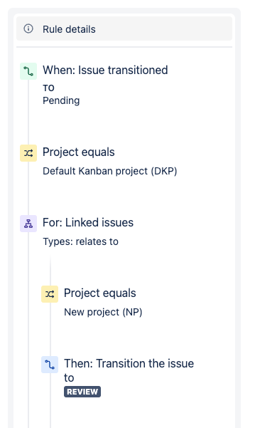

Hi @Sreedevi Raman Pisharody
Why don't you accomplish this with Jira automation.
If have made a simple example that should do the trick.
July 26, 2023
@Marc -Devoteam-
Did you mean Automation for Jira Plugin, If yes I could not find the plugin available for Jira Server version.
Our instance of jira is currently running on Jira Server version and is likely to migrate by start of next year only, hence unable to use Jira automation.
