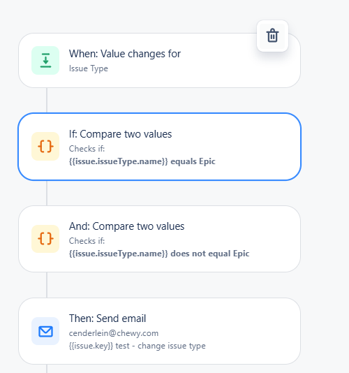

Casey Enderlein
January 22, 2025
Thanks for your feedback, Trudy. In reviewing the article you shared, I am a bit unclear onw where I would add the smart values to check previous VS new issue type values (if a change was made). Here is a screenshot of what I have setup currently, and is not working.2025-01-22_9-39-46.png

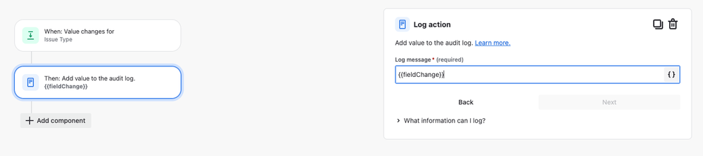

You have to use the {{fieldChange}} smart value. This is a special smart value available only when you use the Field Value Changed trigger.

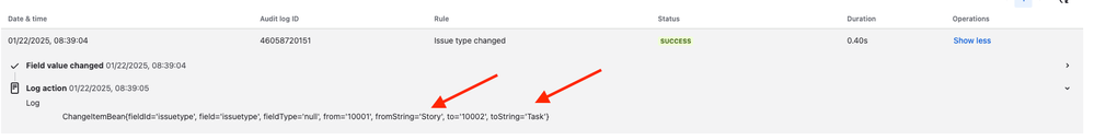

An excellent testing and debugging tool is the Log action. You can use that to write out data to the Audit Log when the rule runs. Here is a test rule I did, triggered by a change of Issue Type, and just writing out the information available from the {{fieldChange}} smart value.
Screenshot 2025-01-22 at 8.39.38 AM.pngScreenshot 2025-01-22 at 8.41.42 AM.png

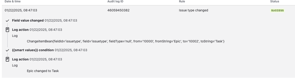

You can see in the Audit Log that the "from" and "to" attributes have the original and new issue type IDs while the "fromString" and "toString" have the original and new issue type names.

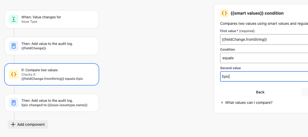

So you can use {{fieldChange.fromString}} in a comparison to see if the original issue type of the issue  was Epic.
Screenshot 2025-01-22 at 8.47.38 AM.pngScreenshot 2025-01-22 at 8.47.25 AM.png

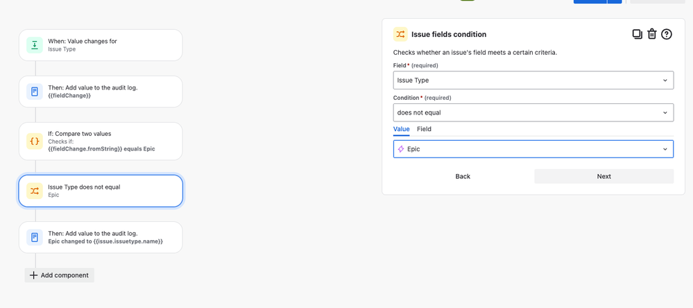

As an added measure you can add a Issue Fields condition to confirm that the new issue type is not Epic, though I'm unsure how you could change an Epic to an Epic.

ahh i see, now it is clicking! thank you so much for your help this worked.
