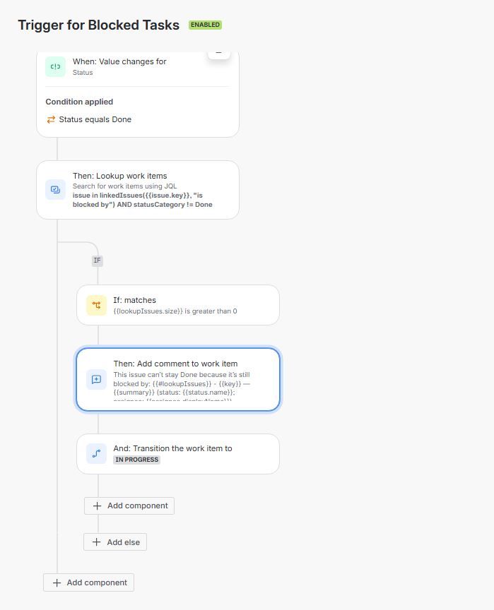

I have a JIRA Project with Type Team-managed business. I have created Task_1 and Task_2.  I had set up Task_2 as blocked by Task_1. Goal I am trying to achieve is, I should not be able to Close (change status to Done) on Task_2 as long as Task_1 is Open (Status should not be Done).
So to implement that, I have used Automation Trigger. I am attaching a screenshot for the Trigger I have written.  After implementing this trigger I am able to close Task_2 with Task_1 still being open. Can you please let me know if I am making any mistake here.

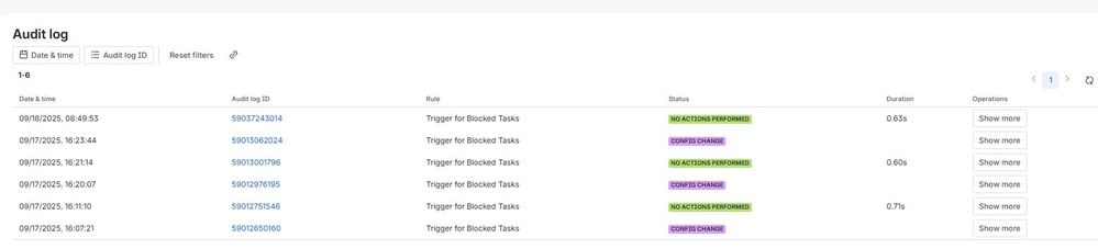

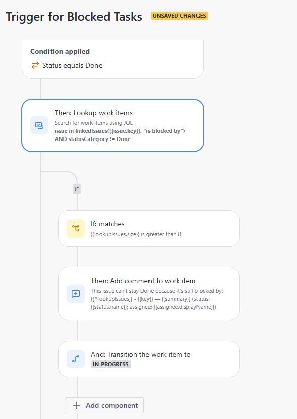

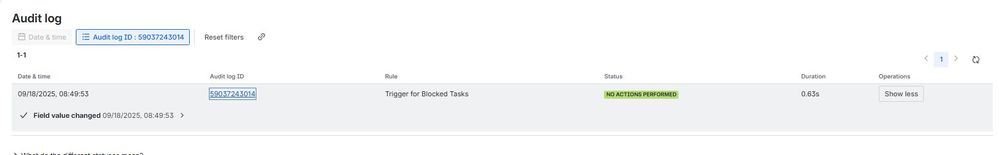

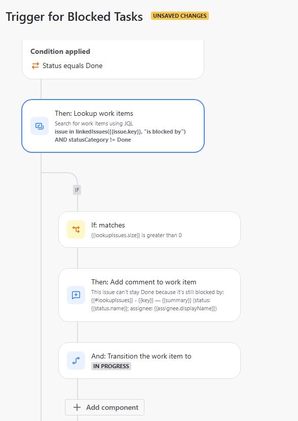

Mahesh Ghanta
September 18, 2025
Thank you @Bill Sheboy
I have attached 3 screenshots. One is for the Rule and the other 2 are for Audits. I am positive I am using Task_2 is blocked by Task_1, and I can successfully close Task_2 without the dependency on Task_1 status. Both these are tasks are under the same project.

Let's make two changes to your rule and then re-test it:
  • The new feature to add conditions to triggers conceals why a rule did not trigger.  Until Atlassian solves that and other limitations with this feature, I recommend not adding conditions to triggers.  Instead, add a separate condition after the trigger.
  • Your rule uses the Field Value Changed trigger on Status.  However, there is a separate trigger for Work Item Transitioned because that is a different event type.  Please change your rule to use the different trigger.
After both of those changes, please re-test your rule.  Thanks!

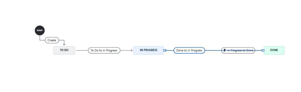

Mahesh Ghanta
September 19, 2025
Thank you @Bill Sheboy I have made one change to my Worflow and it started working. Earlier I had my workflow transitioning only from In Progress to Done, now I have also enabled the Transition from Done to In Progress and the Trigger started working fine. I have attached sample screenshot for the Workflow.Jira Workflow.JPG
Appreciate all the help you have provided here.
