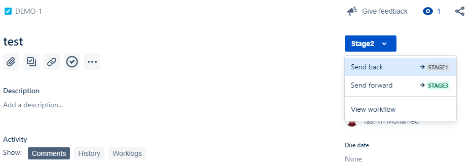

I have a 3 statuses in my workflow (Stage1, Stage2, Stage3 ) and back and forward transitions between them.
What I actually need to ask is that if there is a way to show the transition button to the next stage on the top and then the transition to the previous one down not the other way as it appears in the screenshot below.
I have tried the opsbar-sequence but it does not seem to be working for me.
Thank you.

Greetings @Yasmin Mohamed
to reorder the buttons you can use the opsbar-sequence transition property, described on the following site under "To change the order of transition buttons":
https://confluence.atlassian.com/adminjiraserver073/advanced-workflow-configuration-861253591.html#Advancedworkflowconfiguration-transitionproperties
Hope this helps.

Yasmin Mohamed
May 5, 2020
Thank you for your response, however I have already tried this before and it did not work for me that's why I asked this question.
Michael Wohlgemuth
May 5, 2020
Oh, i missed that line. Im sorry! This is, however, the only way i know to reorder the transitions. If that doesnt work for you i cant give any helpful tips sadly.

Matthew Canham
July 29, 2020
Hi @Yasmin Mohamed
I wanted to chime in here and let you know that the opsbar-sequence property is now honored in the new issue view. Previously it was only available in the old issue view which is likely why you were having issue getting this to work. You can find more information on the public ticket.
Kind regards,
Matt
