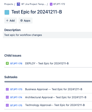

Kerry Borden
February 19, 2025
Thanks Bill.   Our epic screen resembles this.  To you point the "subtask" section doesnt include subtask issue types. the DEPLOY jira is the one that should not transition unless the 3 "subtask" section jiras are in APPROVED/NA status

Bill Sheboy
February 19, 2025
If the issue hierarchy was changed to use the parent field for the relationships, either of the workarounds I noted may work.  This would require automation rules to both checking the issue type and the parent to decide when to revert a transition (or add the indicator to prevent it).
I recommend working with your Jira Site Admin to configure those rules given the changes to the issue type hierarchy.
