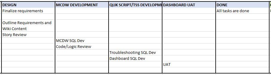

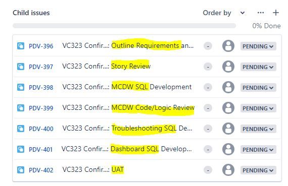

Thanks, @Florian PEREZ _Valiantys Administrator_ .  I'm not quite following how to use the label.  If a use case helps to clarify, Here's my scenario:  When an issue is created, an automation creates 7 subtasks.  These are the tasks that will be performed in develpling our code, are done in basically this order,  and can be assigned to various team members.  The workflows on the board are shown below.  Subtasks have a workflow of Pending, In Progress, and Done.  I would like the parent issue to move through though the workflow on the board based on what subtasks are completed.  this way it's easy to see on the board where the issue is without having to open the issue to check the status of the various subtasks.
So my thought was to check status of subtask where summary contains "Outline Requirements" and the status of the subtask where summary contains "Story Review" and if both are Done, transition the parent issue to Development.   Could you elaborate on how labels would be used in this case?
