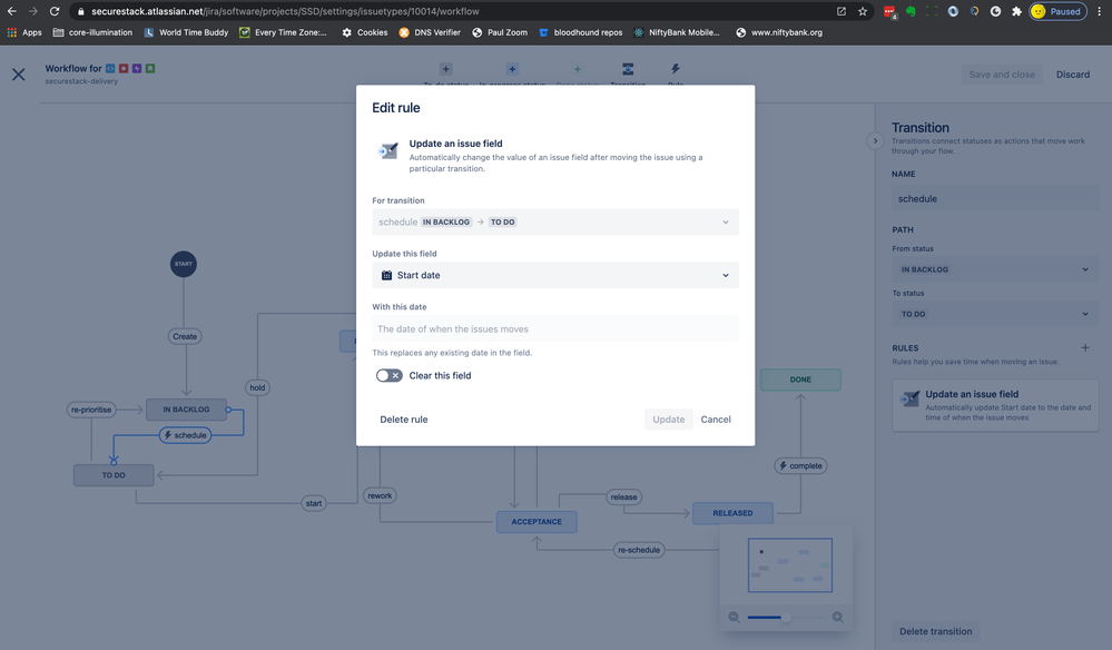

Here is transition rule:

Yeah my approach has already been what @Eoin suggested - I am using the preconfigured update start date field on the workflow editor but it doesn't appear to be working when I move a task from the source status to the target status.
