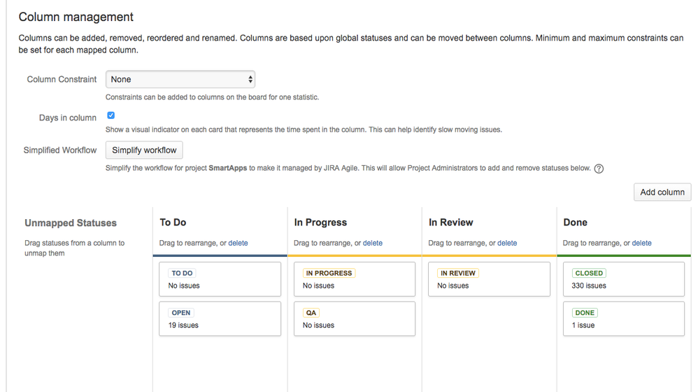

I've been banging my head against the wall for too many hours and cannot figure out how to transition an issue within my active sprint. I have permission to transition issues in the project, I believe I have my status mapped correctly for each column

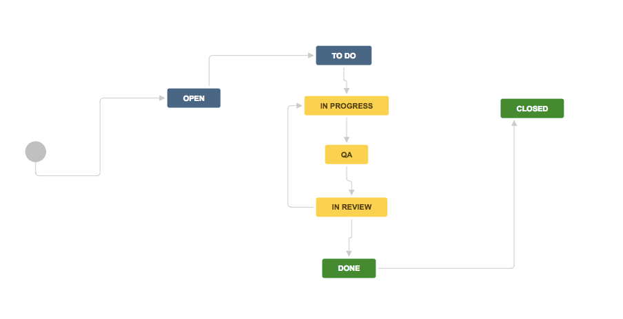

And this is my workflow.
Screen Shot 2018-02-02 at 11.42.04 AM.pngI've read through tons of documentation and cannot seem to figure out what I am doing wrong. PLEASE HELP!!!

Does my workflow (screenshot in original question) look like it is set up properly?

Jenny Davies
February 2, 2018
Thanks, Jack. I actually realized I had a board configuration issue. I had some key statuses that were not mapped to the correct column. I appreciate you helping me troubleshoot!
