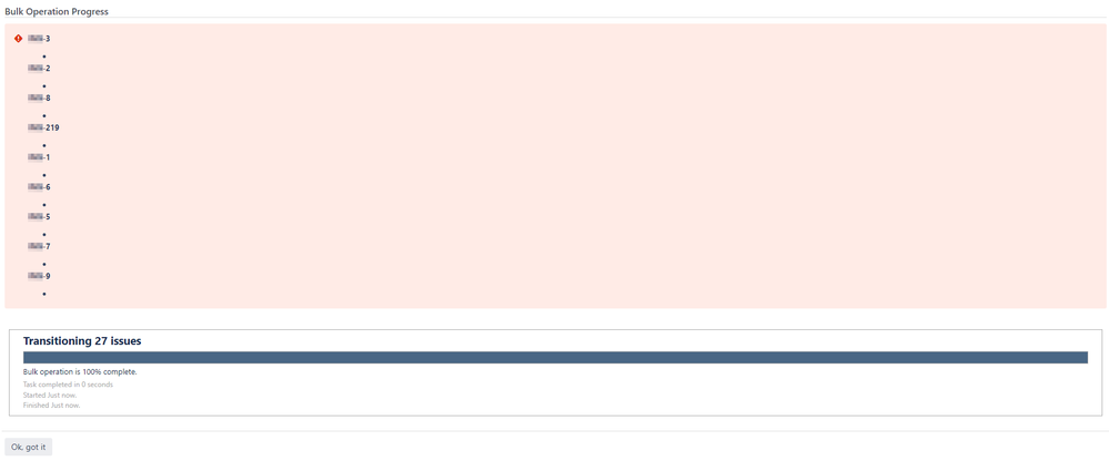

I have now added the status to the workflow as an initial status after creation, but I cannot perform a bulk change for it.
So currently I am kind of stuck in the workflow configuration and try to avoid the recreation of the issues in any case.
