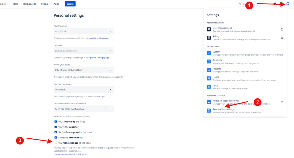

Hello @Matt Houck
You executed the status transition. Are you also the Reporter, Assignee, or Watcher of the issue?
Have you reviewed your personal settings to confirm you don't have any settings that would prevent them from receiving the notification? For example, if you make the status change and you are the Reporter (or Assignee or Watcher) of the issue, but you unchecked the option to receive notifications for changes you make, then you wouldn't receive that notification.

Najm Polaris
February 17, 2023
Hi @Matt Houck
Check this settings as @Trudy P Claspill explained.
