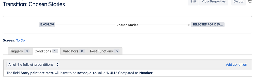

Hi all,
I've been trying add a transition condition that prevents an issue from being moved from Backlog to Selected for Development if the field "Story point estimate" has no value but it doesn't seem to work.
Here's the transition setup:

Alexey Matveev
October 28, 2018
Hello,
If you are on Cloud, then there is the Field Required validator.
If you are on Server, you would need an add-on.
For example you could use the Power Scripts add-on:
https://marketplace.atlassian.com/apps/43318/power-scripts-jira-script-automation?hosting=cloud&tab=overview
You could add a validator with the following script:
if (!hasInput("customfield_10200")) {
   return false, "customfield_10200", "Enter Story Points";
return true;
10200 is the id of the Story Points field.
You can find more info about validators here:
https://confluence.cprime.io/display/JJUPIN/Customizing+workflows
David
October 27, 2018
Hello David.
Can you set other type of comparison? Maybe a number comparison does not match with the "not null" check you are using.
Nice regards.
David
October 27, 2018
Hi David, I like your name!
I've tried that but it doesn't work unfortunately.
I've tried the following:
!= NULL (type number)
!= NULL (type string)
>0 (type number)
Thanks,
David
