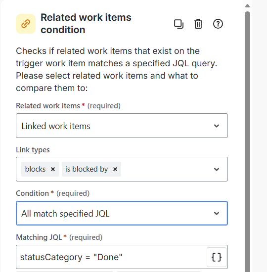

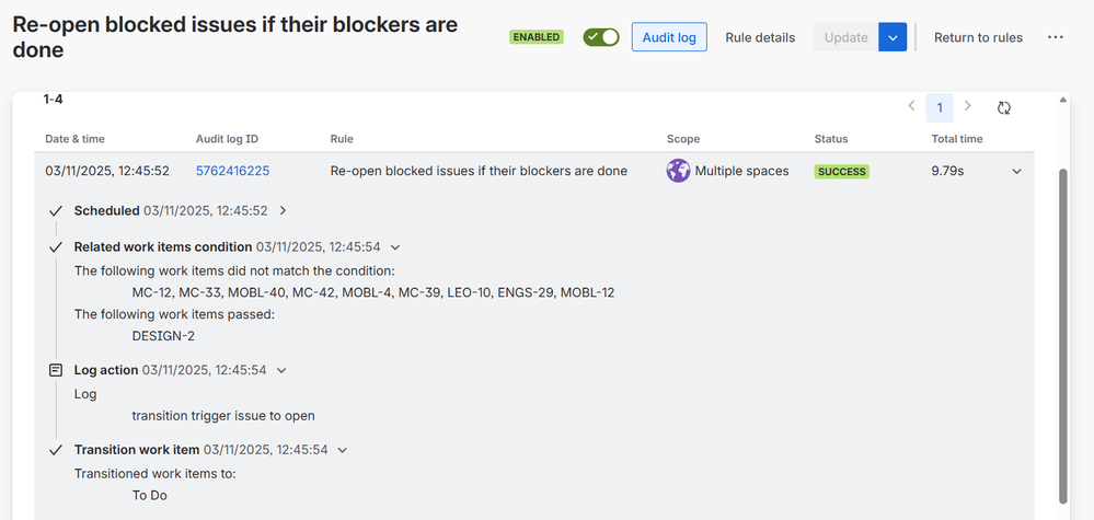

November 3, 2025
I got this working, but I am not sure if it is exactly what you want / need -
Trigger: Schedule on this JQL
issueLinkType = "blocks" and statusCategory NOT IN ("To Do", Done)
Condition:
Action: Transition the object to an open status, in this case, 'To do'
Let us know if you have questions / need other help.
