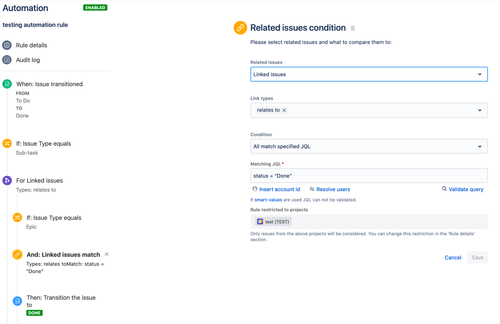

Hi everyone,
I have a requirement where i have issue type 'Accommodation' with a subtask allocation. Multiple Accommodation issues are created and the subtasks are linked to an Epic. The accommodation issue has no link to this epic.
I need the Epic to transition to a status 'Ready to Load Allocation' When all the subtasks that are linked within the epic are transitioned to 'Done'
I have tried multiple post functions and conditions and I have been playing about with project automation but cant get this to work.
Annotation 2020-06-26 164947.pngPlease can someone help me to get this working. We have JWME if that will be helpful?

Hello @Emily Fuller
Thank you for reaching out.
Per your description, I was not able to clearly identify what is the exact relation/link you have configured between your sub-tasks and Epic issues. I believe you have used the default issue link functionality, is that correct?
If that's what you did, you can automatically transition an Epic when ALL the linked sub-tasks are transitioned by using Jira Automation. You can follow the template below where "Relates to" would be the link type you used to link sub-tasks and Epics:
P.S: To ensure the automation above will properly work, you must use an exclusive Link type to link your Sub-tasks and Epics, ensuring this link will not be used to link other issues or for any other purposes.
Let us know if you have any questions.
