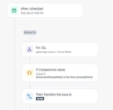

I would like to create an automation that does the following:
  1. Run every morning at 9am
  2. For features that are part of the "Out of Office" Epic, if due date or end date is in the past (i.e. earlier than today's date), transition feature to "Test Complete"
I've already started building this out where I use "Scheduled" to make this occur at 9am every day. My final step of the automation rule is "Then: Transition the issue to Test Complete", but I'm having trouble getting it to work with the intermediary criteria (bullet #2 above).

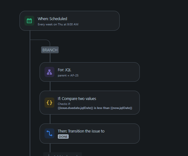

You can archive this with a Branch a JQL.
Here is an example, where JQL
parent = EPIC_KEY
Hope this helps!

Rachel Stein
August 23, 2024
Thanks Sam! I appreciate the response. The recommendation is not working for me.
Here is a screenshot of how I set it up (note that I need the Parent Epic name to be "Out of Office")

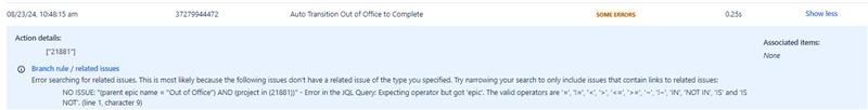

I am getting the below error when I do this:
Bill Sheboy
August 23, 2024
Hi @Rachel Stein -- Welcome to the Atlassian Community!
It appears the JQL in your branch is incorrect.  Should the field name be enclosed in quotation marks, or instead you could use the epic key, as Sam described.  (I suspect you will need the key or to alter your rule to find the epic first, by name, and then use the key in the branch's JQL.)
