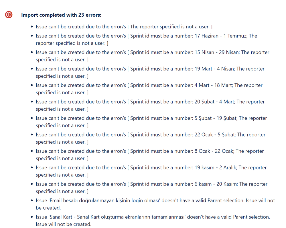

Hello, I am transferring approximately 700 tasks from one company to our company. While performing this bulk operation, I am encountering the error shown in the screenshot. Could you help me with this issue?

A assume you are importing your issues via csv?  It seems like you have more than one challenge:
  • for some issues the target environment does not recognize the reporter. ==> Ensure the reporter accounts are active in the target environment  or replace them in the csv file with active users
  • for one issue you refer to a parent ticket that does not exist. ==> remove this from the csv file and manage this ticket manually post import
  • csv file does not recognize the sprint id value ==>  Doublecheck that you refer to an existing sprint in the target environment. see here for the current limitation for importing sprints https://jira.atlassian.com/browse/JSWCLOUD-5942

If you are using csv export, then the error describes that an user mentioned in one of the spreadsheet columns does not match the user defined within JIRA.
Check the usernames match between jira and csv and update the csv as needed.
Also use  username, not display name.
