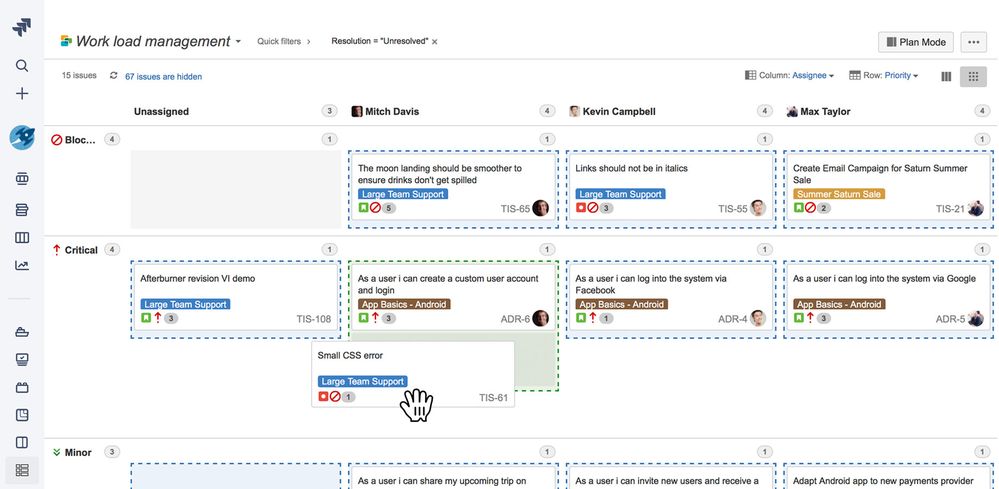

There's an app called Comala Canvas for Jira that may fit for your use case. You can create boards with rows and columns, selecting any field, like the following example:
Hope this helps!

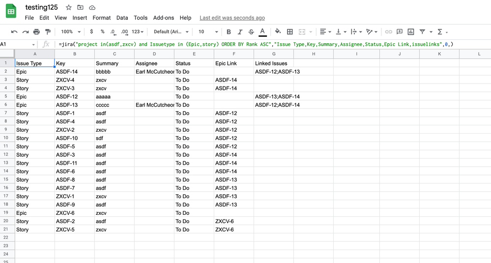

The layout in the example below is 2 sheets titled Sheet1 and Sheet2.  On Sheet 1 I have a basic data pull using the Jira Cloud for Google Sheets (Official) connector app with a =jira formula like this:
=jira("project in(asdf,zxcv) and Issuetype in (Epic,story) ORDER BY Rank ASC","Issue Type,Key,Summary,Assignee,Status,Epic Link,issuelinks",0,)
It outputs the raw data dump like this, noting that I have Epics in both projects (ASDF & ZXCV), and the epics are tied to Stories in each project as well:

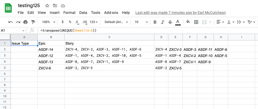

On Sheet 2 I set it up to show headers as the unique issue types from sheet 1 then using those headers to set up a few different join, filter, and query breakdowns to show the Stories that are connected to the Epics.
As a reference here is a screenshot of that data output once all the groupings occur, Column B is the list of Epics in the two projects, Column C is a Comma-separated list of the Stories in the rows Listed Epic, and then Column D-H is a list of the same stories from C however spaced out in individual columns for an alternate view of the data:
In Cell B1 I have the following formula that gives me a vertical list of all the epic issue types from sheet1 based on the header Row titled "Epic":
=filter(Sheet1!B:B,Sheet1!A:A = B1)
Next, I broke the subsequent stories out in 2 ways Column C is a condensed, comma-separated list of the stories in the Epic, and Columns D - H are those same stories but listed out as individual columns depending on whether you wanted a condensed list or an individual data point per issue.
to set up column "C" for the condensed list, in rows 2-5 the following Formula is used to generate a comma-separated list of all the stories contained in the Epic from column B iteration the row number for the B cell reference:
=join(", ",transpose(query(Sheet1!B:F,"Select B where F matches '"&join("|",split(B2,","))&"'",0)))
To get the individual Story values listed out as individual columns the following Formula was used in column D iterating the B cell reference again noting the transpose will take all available values and horizontally display them to the right of the cell the formula is in so make sure that you do not place an extra date to the right otherwise you would get an error here:
=transpose(query(Sheet1!B:F,"Select B where F matches '"&join("|",split(B2,","))&"'",0))
