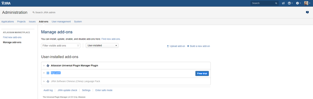

Yes it looks like this addon is not installed
I also disabled 2 addos, updated the first one and perform a re-index it doesnt fix the problem.
