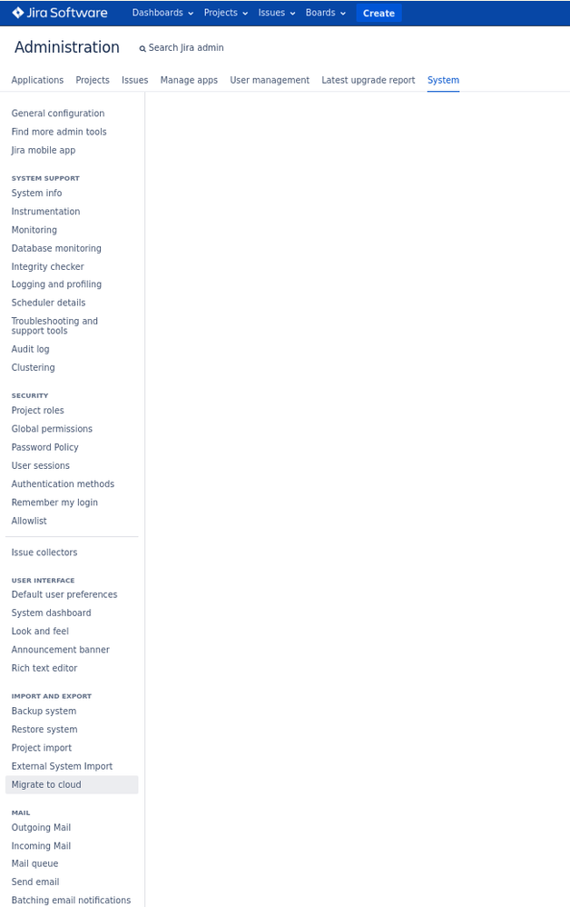

Barrie Walker
February 6, 2024
However, clicking on it brings up a blank page.
By which I mean a page with the menus and side bar but nothing where information or actions would be.
Rebekka Heilmann (viadee)
February 6, 2024
Can you provide a screenshot?
Barrie Walker
February 6, 2024
February 6, 2024
Odd. If you cannot update the existing App under "Manage Apps" you can maybe try to manually install the App.
You can download it here: Jira Cloud Migration Assistant - Version history | Atlassian Marketplace and install by clicking "Upload App" under Manage Apps.Screenshot 2024-02-06 174259.png
However, I don't know what happens if the App already exists in your Instance so try that out in your Test Environment first.
Barrie Walker
February 7, 2024
I seem to have installed that version manually.
I say it like that because when managing apps I get the error "The base URL configuration of your instance does not match the URL in your browser. This can prevent operations on this page from working correctly". I've checked the setting and it matches the url in the browser.
Ploughing on (since it only says "can prevent", not "will prevent"), I upload the downloaded app and I get "An unexpected error occurred. Refer to the logs for more information." (not sure which log to be looking at).
However, "Jira Cloud Migration Assistant" does now appears in the user-installed list instead of the system list.
I've restarted the jira service in case that was needed.
Clicking "Migrate to cloud" still looks as in the screenshot above.
