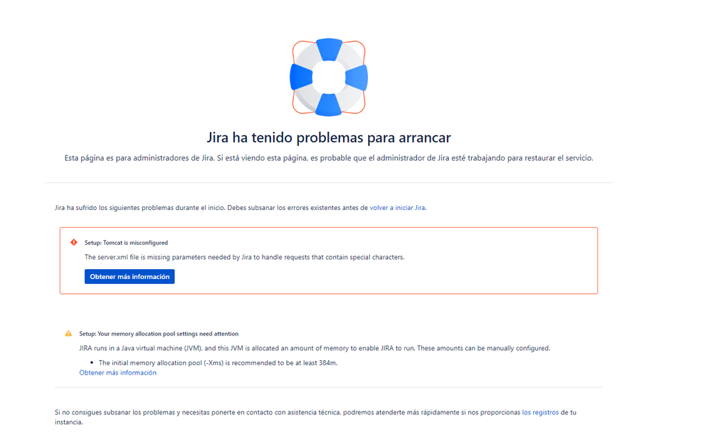

I have tried the standard steps using the JIRA configuration tool, but after restart the JIRA app I get this error:error_jira.pngI understand that the changes I made through the JIRA configuration tool is only making changes in the server.xml file.

My bad for not taking a full PrtSCrn. What I can tell you is that I start the browser and go to https:localhost/8443, and the browser shows that the Jira is loading plugins which is normal after rebooting.
When it finish the web changes and is the prtscr what I see.
