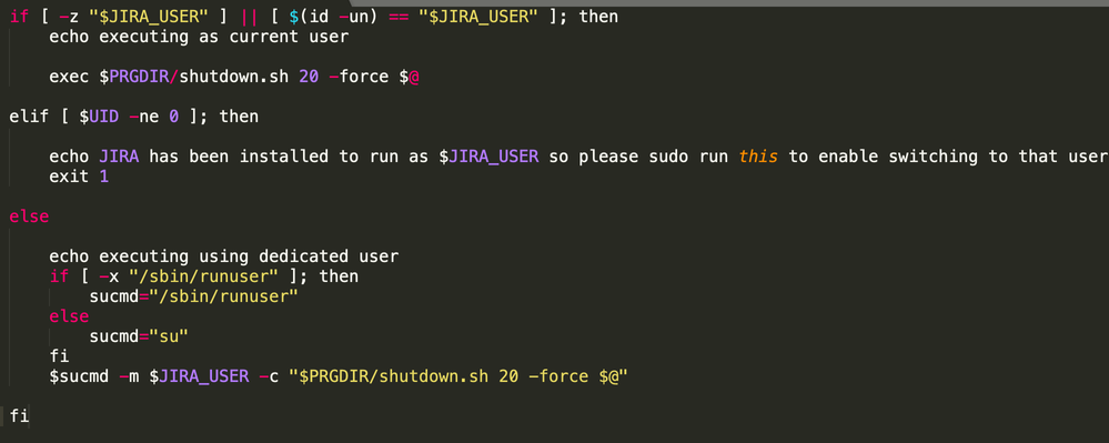

In the Zephyr release list in 5.4.1 it indicates that they have fixed a problem with the server shutdown. check if you have the last version installed
Or you can try increasing the waiting time in the stop-jira.sh file to more than 20 seconds, so that zephyr or any other  applications finish all their processes correctly.
In the attached screen this is 20 seconds is its default value, I have adjusted it for the Insight application to 90 seconds and now it stops correctly
I hope it helps you.

I have the latest version of the application installed and the time increased to 120s and it remains the same.
Thats weird!
