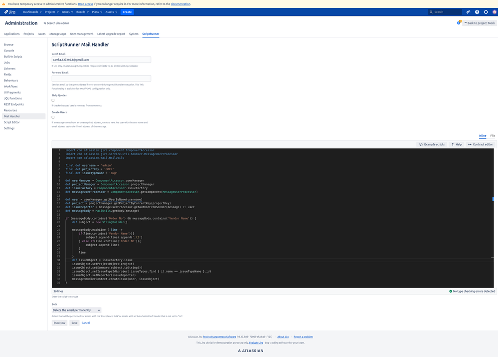

Below are the screenshots of the Mail Handler configurations:-

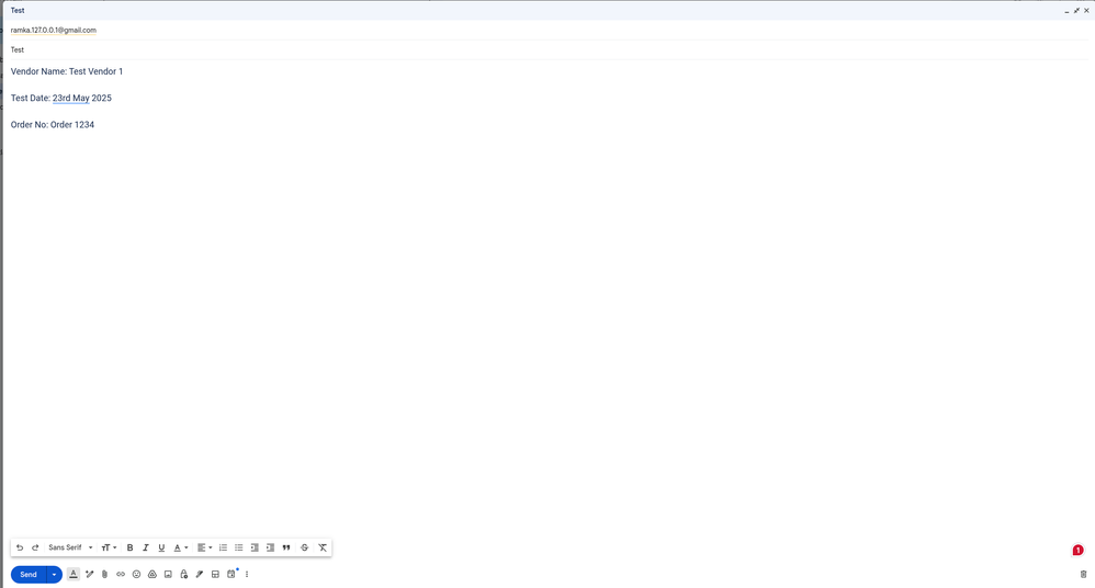

Below is the sample email that is tested:-

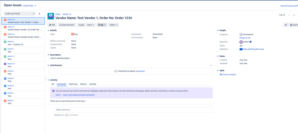

And below is a sample of the output that is produced:-

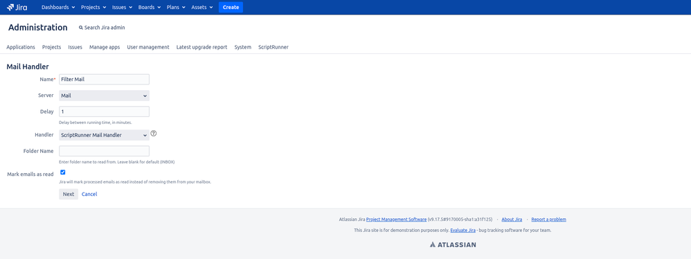

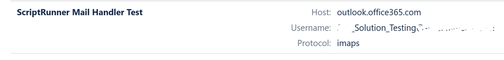

1. Created a mail server with some email addresses and Impas (screenshot attached)
2. Using the same mail server, I set up an incoming email handler (screenshot attached)
3. The catch email address is where we will get the emails, and the same one I mentioned when I created the mail server.
4. I sent a few emails to that email address, and click on "Run Now" to test mail, it's not creating tickets, and showing the message (screenshot attached)

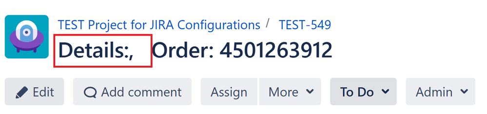

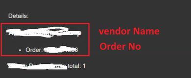

Yes Ram, I sent a few emails, and the tickets have been created correctly. The email of the body formatted this way, but the ticket summary shows like this. Do you know how to correct this?
I want to display the summary like this "TXXXX Foods Inc, Order:4501263912"

It's not extracting the Vendor's name because the vendor name is not on the same line as the Details:
Please clarify, are all the Vendor names below the Details?  If yes, then there is a slight modification required in the code.
