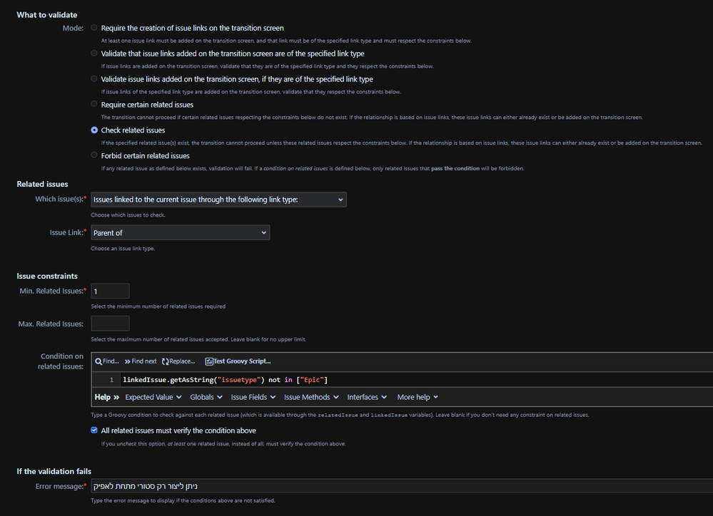

Hi :)
I need to check when a new issue is creating,
if the parent of this issue equals to Epic:
if it is- the creation will be cancelled
and if it is not equals, just then, the new issue will created
I did it with validator on the creating transition that-
checking if the parent issue, is not equals to Epic,
and if it is not- so the issue will created
it's  working well, but not with mine massage error..
waiting to your answer :)
2 accepted
Marc -Devoteam-
August 27, 2024
Hi @Hadassa
There is no option to check any validations before creating an issue in Jira.
There is nothing to validate on if there is no issue created and the parent - child relation is there.
On issue creation you can only validate if certain fields have fields filled with data before creation.

thanks' @Marc -Devoteam- for your answer,
I'm talking about parent - child relation,
how can I make parent - child relation on mine issues-
or, how can I know if there is already?

August 27, 2024
ok... got it @Marc -Devoteam-
so what about 'Relates issue validator'
like what I trayed to do?

Hadassa
August 27, 2024
Hi @Marc -Devoteam-
so what is it for? this validator?

Hadassa
August 27, 2024
Ok, got it now!
This validator not intended for the creation transition,
That's what I needed to understand,
Thank you @Marc -Devoteam- that was helpfully

Jerrold - Empyra
August 27, 2024
HI @Hadassa
Can you please share the error message you are getting instead of the given error message and also can you check if this transition has any other validators similar to this.
Thank  you.
Hadassa
August 27, 2024
thank you, Jerrold for your answer
I just try it now,
and it's not working at all
and the transition doesn't have any validator similar like this .
