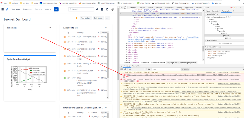

13 May 2020 My Timesheet gadget stopped displaying on my dashboard.
I have reloaded the web page and opened my dashboard in a different browser with no success. I'm using thunderbird and also tried MS Edge.
This is not a Tempo Timesheet, its just a timesheet gadget added to a dashboard.
Any ides why this gadget just suddenly stopped working?

Leonie Lane
May 17, 2020
Thank you Andriy
I have removed and added the gadget several time without success.
I ran an inspection on the page and found this, it this helpful?
 Cheers
Leonie
Andriy Zhdanov
May 18, 2020
That really looks like a cause of empty gadget. Could you please make sure you still have Timer Reports app installed in Jira Settings - Apps - Manage apps.
