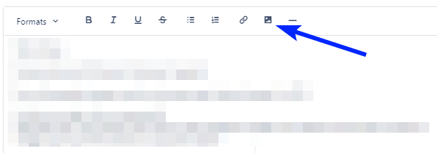

(Typically the initial query post doesn't allow pasting images, but replies should allow inserting images by way of the menu bar, as seen below)

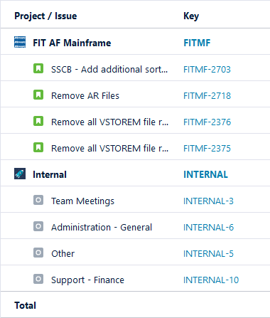

No, I am not using JQL.  I'm just pulling up the timesheet to look at in the browser.  Screen shot of the pertinent portion of the web page is attached.  It is not sorted correctly either by issue name nor by issue key.

In testing on my side, the projects were listed alphabetically, the issues were listed alphabetically as well, based on their summary.

I found the key to the problem.  I noticed that if I enter TEMPO from anywhere else in JIRA that the following is inserted into the URL and the projects and issues on my timesheet are initially in sorted order.
&periodType=CURRENT_PERIOD&subPeriodType=MONTH
If I then change the period to anything else (once I am in the timesheet, itself), then the projects and issues are no longer completely in sorted order -- but they used to be.
I use a browser bookmark to get to my timesheet directly.  In that URL, I have &periodType=FIXED specified with &from and &to dates for the current TWO-WEEK period.  This is why I see an unsorted list and you are not able to duplicate it.
