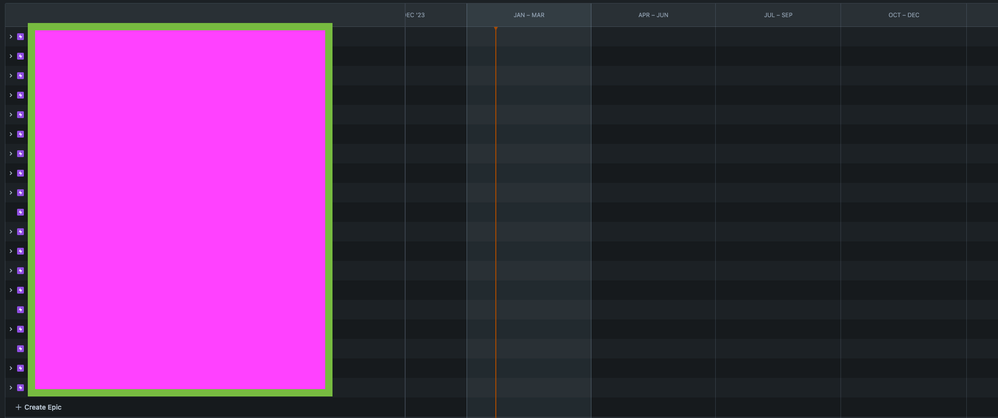

Our "Timeline" view in Jira (Software project) is not usable. Our list of epics show (child tasks also when expanded) but there is nothing to interact with or visible for the actual timeline. There are no boxes that show any duration of time, that you can see or interact with.

The Timeline you see is really the planning feature. Jira - unfortunately - has multiple timelines, depending on the cloud plan you have and the type of project you are in. Since it seems you are on a standard plan, the timeline you are talking about is a basic plan that should work as long as the board your timeline is on shows data from 1 project only. That seems to be the case, as you can see issues displayed on them.
Next, the fact that the start date field is locked in custom fields is not a problem. That only means that it is a system field and that you cannot change its configuration. But that is perfectly fine.
The timeline use the start date and due date fields to display your schedule. Normally, when you click on the calendar next to an issue in timeline view, it should add a duration bar in the schedule. Doing so then automatically fills out those fields.
From all you describe, I deduct that you are in a company managed project in Jira Software. To be able to set the due date on issues, you need to have the schedule issues permission in your project. That may be something worth looking into.
And finally, to make sure you can also schedule child issues (of epics), you need to enable child level scheduling for your timeline. Locate timeline settings (you can do so via the kanban board view > configure board > timeline) and set the toggle for child level scheduling to on.
